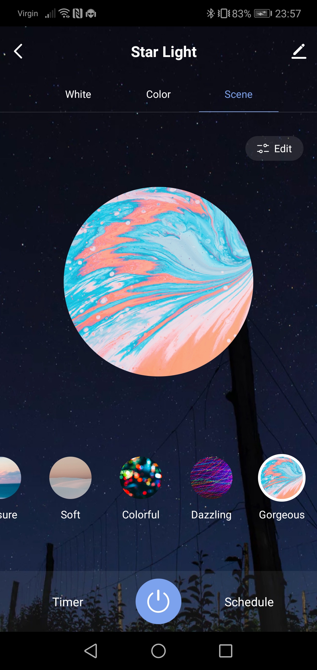

When it says Offline in the Smart Life app, I cannot then ping its LAN IP anymore. I have to kill the power turn it back on again and then it more or less instantly becomes Online again and I can ping it again.

Had to remove the device from the Smart Life app and pair it again, now connected to the Guest WiFi.
Looking in the Device Information in the Smart Life app it’s IP address is now shown as the same IP as my WAN external IP. Guess this is what happens for devices connected to the Guest WiFi network on my Asus Merlin router.

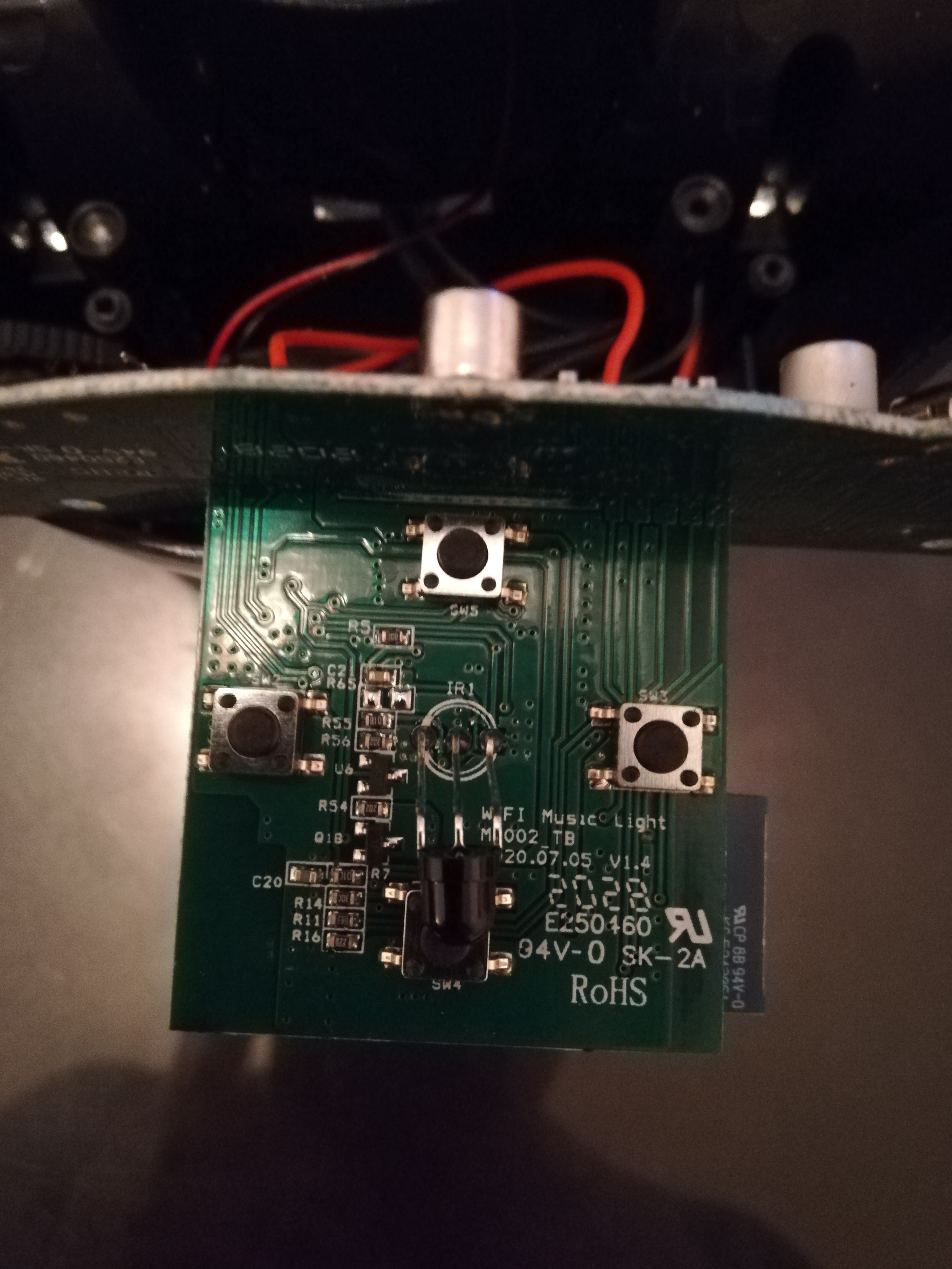

Some people are changing them with esp-12, that seems to be pin compatible, but it’s more effort than probably needed. It’s a shame they’re starting to use this Soc just to prevent people from flashing them.
Look for the chipset. I’ve seen all kind of devices with esp* being flashed with tasmota, and there’s even athom (see aliexpress) producing bulbs and switches already flashed with Tasmota.
EDIT look at this, you’ll find known compatible devices here EU Devices
