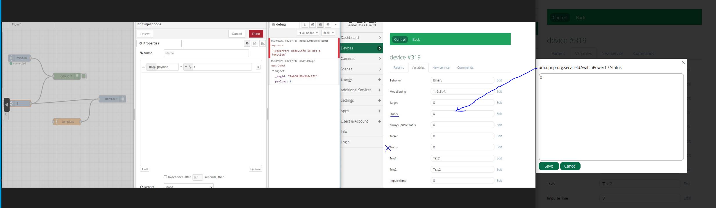

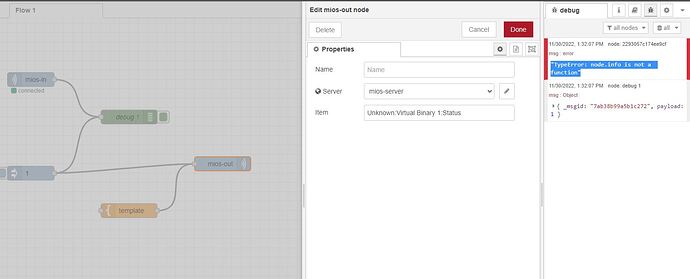

I just started with NR yesterday. Been busy with this for over a day now. The Mios-out node is not updating my virtual switch in vera. I have tried every combination I can think of.
The first thing I notice after looking at the examples above is that when setting up the mios-out topic with:
Unknown:Virtual Binary 1:Status
im getting an “TypeError: node.info is not a function” as a result
the only way to fix it is to add an additional " : " at the end
Unknown:Virtual Binary 1:Status:
I tried all sorts of combinations for the Variable section, even using variations of: urn:upnp-org:serviceId:VSwitch1 / Status as the variable.
I tried with the inject node, template, and change node. I tried sending a new status to a non-virtual switch as well with now luck.
can someone please give me a hand here and show me what im doing wrong…or is the mios node with vera recently broken??
