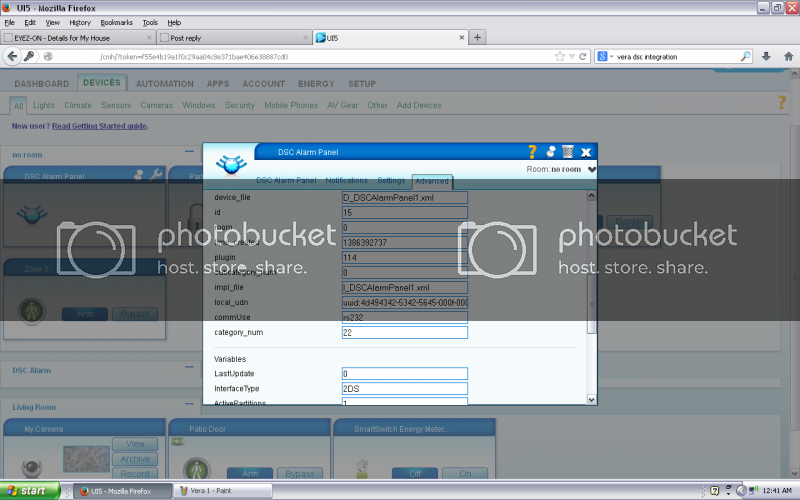

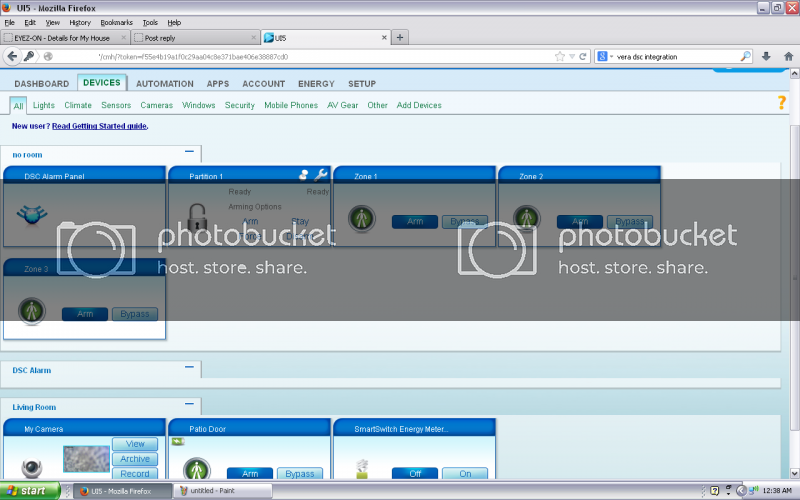

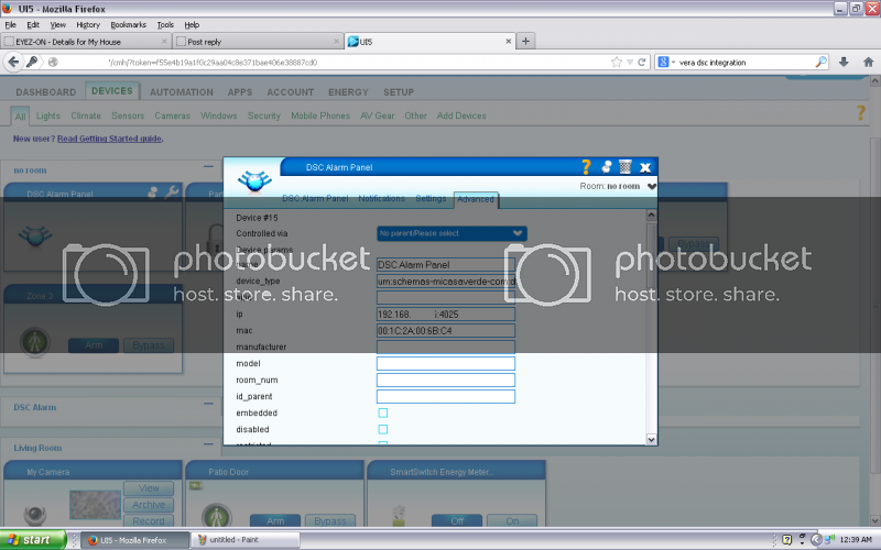

I’ve got the DSC app installed, but I’m getting no changes in Vera when a door sensor is tripped, I have tried them all set as door sensors and motion sensors, to no avail. I get no triggers (My green guy never becomes a running red fella.) Everything on the DSC side works fine and the zones are also properly labeled, though they never transferred to Vera.
I’ll attach some screen shots of my settings. Thanks so much for any and all help you are willing to offer.

Any errors listed in Veras status window?
Is there communication with the panel though… you can arm etc?
Did you set the DSC system up yourself? What are your actual zone numbers?
in your setup, I see you have 1,2,3, but do they correspond with whats actually programmed? At least the first 1-8 zones normally default as wired connections in the panel setup, and wireless zones would normally be added as higher numbers such as 9 and above (assuming no zone expander).
[quote=“strangely, post:157, topic:174399”]Any errors listed in Veras status window?
in your setup, I see you have 1,2,3, but do they correspond with whats actually programmed? At least the first 1-8 zones normally default as wired connections in the panel setup, and wireless zones would normally be added as higher numbers such as 9 and above (assuming no zone expander).[/quote]
The zones do not correspond with the zone numbers on the DSC. I did set up the DSC myself, with some help from tech support (it was a touch overwhelming at first.) Those zones are 9, 10, 11. Do I need to change the zone numbers to that? I thought I read somewhere that they didn’t have to correspond, but maybe I’m imagining that and that’s why they’re not working.
I don’t see any errors in Vera, but I’m not positive how to check that. No, I can not arm, disarm, stay, etc. It says remote arm is not enabled. I’m assuming that’s because I have it turned off in the settings, but arming remotely from Vera isn’t really an option I need. I just want to be able to set up scenes off the DSC sensors. I can use my remote EyezOn portal to remotely arm/disarm when I need.
Thanks for the timely response!
Paul
EDIT: Just renamed the zones to 9,10,11 and it works. That was the problem! Thanks again so much!
You must input the zone numbers that correspond to the type of device in the Alarm panel properties of the plugin. The plugin does not automatically add the zones.
