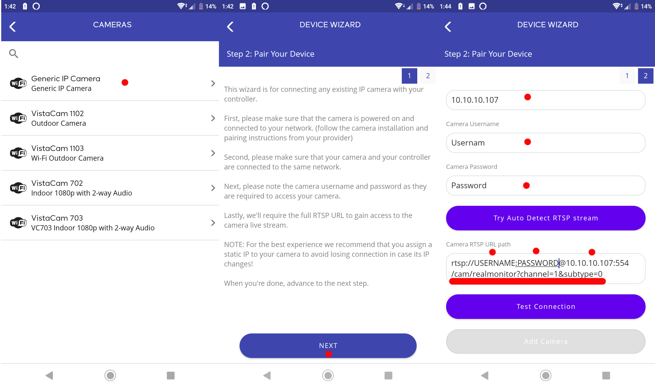

Just to update anyone attempting to add cameras. Use the MiOS Mobile App, mine is on Android.
I was advised by support to try adding the fully qualified IP address /username and password autodetect does not work but may false detect my cameras.
It will be redundant to enter the IP address, username, password into the required fields but also include this same information before the “camera RTSP URL Path”
It is required for the video to be visible and live on the dashboard.
Great support MiOS. I was losing my mind!
FULL PATH REQUIRED (check your manufacturer and use the fully qualified path) The Camera Wizard will NOT concatenate the username and password and IP with the manufacturers path as the wizard would suggest the short URL WILL ALLOW CREATION BUT NOT WORK>
EXAMPLE
/cam/realmonitor?channel=1&subtype=0 (the add cam wizard will accept the short URL but the video will not play on the Dashboard.
Doing it manually/redundantly is required. Check your work because you will NOT be able to edit this for errors.
rtsp://admin:PASSWORD@10.10.10.10X:554/cam/realmonitor?channel=1&subtype=0
RTSP-EzLO
