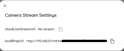

However all my camera devices in Ezlogic web UI have a local URL like this

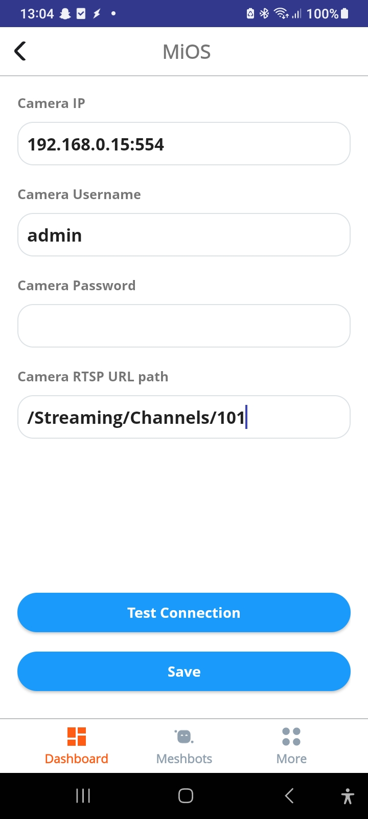

Right I remember the local path you explained earlier, so I noticed it. when I was there on site on the same LAN I set them up and they worked. I am remote set one up again and that one does not have the URL. This still can not be edited once created using Vera Mobile
That’s a bug in the mobile app(s) where you cannot edit the connection settings for a previously added cam, there is a ticket for it, but looks like it has not been assigned to a dev team as yet.

I was referring to not being able to edit a cameras existing connection settings in the mobile app, as the Save button seems to do nothing (In Android not sure about iOS version)
Android Mios app:

For a 3rd party RTSP Camera you just see this on the menu.

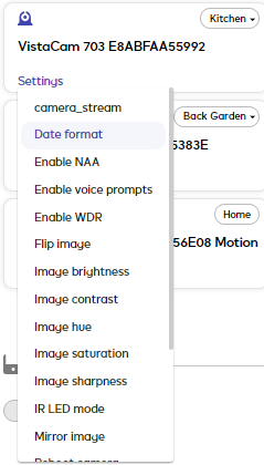

However for one of Ezlo’s own VistaCam branded cameras you get this full menu of settings, but none related to the initial connection settings of the camera though.

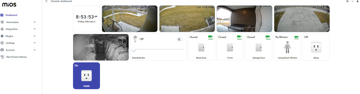

The working unit has this dashboard, older firmware, home modes work etc.
Screenshot 2024-02-02 085401

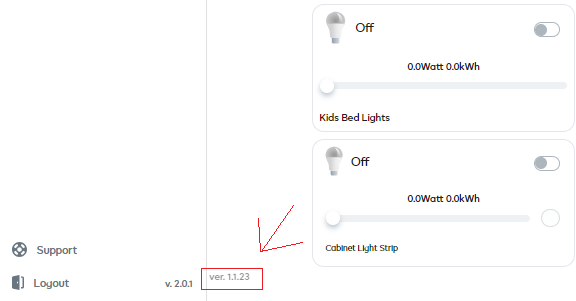

My dashboard version in Chrome says its version 1.1.23

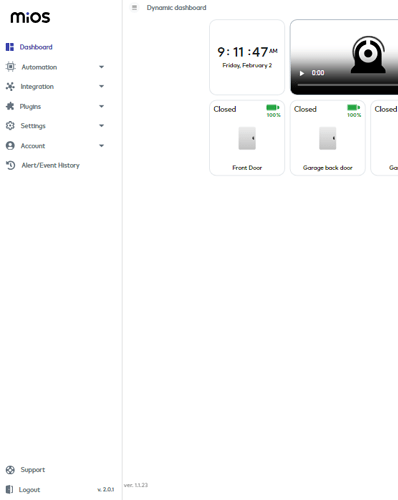

Using Edge
The broken dashboard here 1.1.23

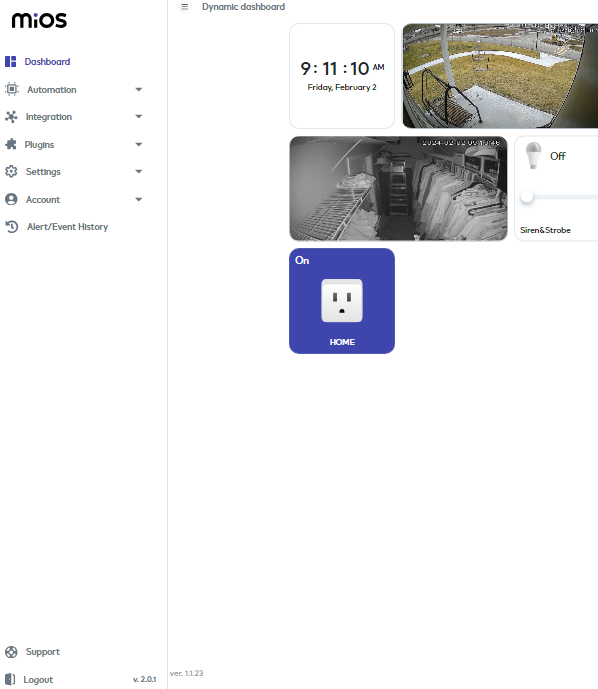

Screenshot 2024-02-02 091157
working dashboard here 1.1.23

I Just watched the live video with audio seconds tick off for 5 cameras for over 1 minute. Then put one in full screen again live video/audio for over a minute.
Its really impressive.
I now have a unit that did have working RTSP cameras on the dashboard but recently after the unit was restored from a backup, the cameras dont work. Deleting and readding them results in the app showing the camera image but live stream fails in the MiOS app and the dashboard displays not video. This thread is over a year ago does anyone have a way to view the RTSP stream in the dashboard?
This is still a bug a year later, I just tried adding and still no edit of the stream information in the device settings using the MiOS app. ;(
Hi @focusedcoder
I had a similar problem with my Amcrest IP camera. Have you tried to enter just “/” as an rtsp_url_path? It worked for me. At the same time, Amcrest’s official documentation states a different RTSP URL.

We have re-added your doorbell camera, but the streaming is not working because the camera codec (H265) is not supported. Could you please check this setting in your camera’s configuration and change it to H264?
Thanks i will look into that. What about the other ones? I have noted somewhere no changes were made to the cameras or settings these all stopped displaying after support reset this unit with a back up so thats still the only thing changed not the camera settings. But I will check them.
I checked my cameras using the factory app and they are all available to me. AntonS has indicated that the path I should use setting them up in the Ezlo Mobile App is just a “/” can you confirm that?
and is there a way to add them and edited them after creation?
