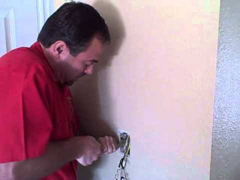

You can learn alot on Youtube… Just make sure the beaker is off and that the one that is off is the right one, or kill the master.
“OLD WORK” boxes are easy.
