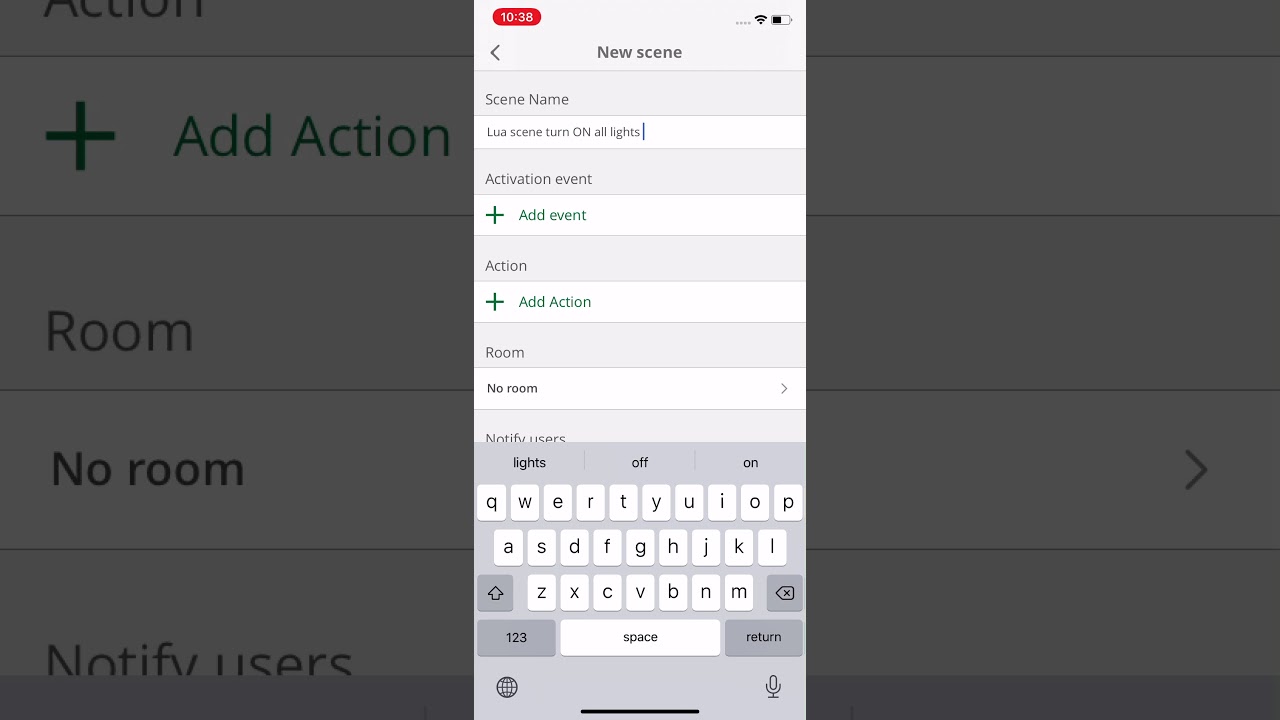

Hello everyone,
As you know you can add lua codes in scenes as actions. Here you can see how if you have not tried that yet
https://youtu.be/4OwuZJX72lw
You can add your sample lua codes by going to Settings → LUA Scripts → and writing the code with a name. This name will appear in scenes, when you want to add a LUA Script as an action.
You can do all sorts of powerful actions that you might require with adding lua code to your scenes. However if you have not yet tried this powerful tool below you can see some basic examples of codes you can copy paste and try right away:

Hi @MCakan,
I think your example of code in the app screen shot is for use in the the API tool and not how to enter it in the app it self. That is at least how I did it.
Cheers Rene
Thank you Rene, You are right. I updated it :+1:
