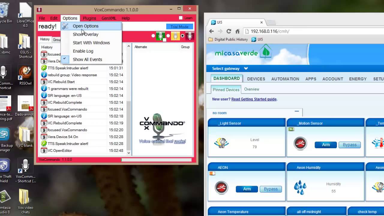

So, I pointed the VoxCommando Vera plugin to my Vera’s IP and port and then created a new group called Vera and started building commands.
The plugin exposes a number of actions for the Vera:
Vera.SetState
Vera.Get.Humidity
Vera.GetScene
etc
To turn my kitchen lights on/off, I simply create an action:
Vera.SetState, provide the device number and what state you want
You can provide a number of phrases that trigger the action: Kitchen Lights On, Turn Kitchen Lights On, etc. The speech recognition has been very good so far, no mistakes yet
Also very cool is the ability to return spoken text from a voice query (e.g. is the front door locked?) you can then use text to speech to have the response spoken back to you: the front door is locked. Or what is the temperature outside?
Anyway, a cool demo of VoxCommando:
It works pretty well for my Vera control
