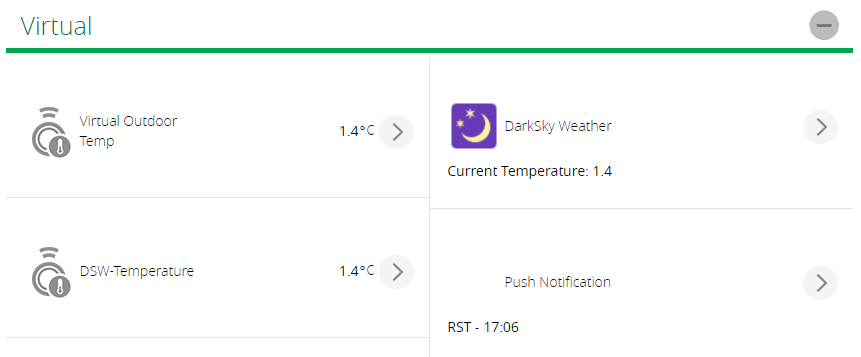

@reneboer,
I’m making progress, switch back to TempSource 2, and reload the luup, and the VOTS displayed the DarkSky device Temperature now (1.7C))! But the thermostats aren’t (still 4.0C), will wait maybe there is a timer for updating the thermostats…
I’ll try to switch back to TempSource 3 later to see if it will start working! I’ll let you know the results!

I pushed again the code you change and reload luup, now the VOTS Temp changed (near to the one from DarkSky) which the the TempSource I selected.
Capture
But the thermostats does not update to 1.4C, still 2.0C from the update time of the original plugin.

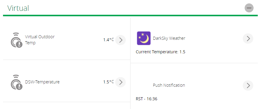

I did test it again by switching to TempSource 3 and reload luup. No change, reboot again Vera, and no change:
Capture1
And thermostat still display 2.0C
From my tests, the EXT temp does not seems to update on the thermostats, source 2 or 3.
