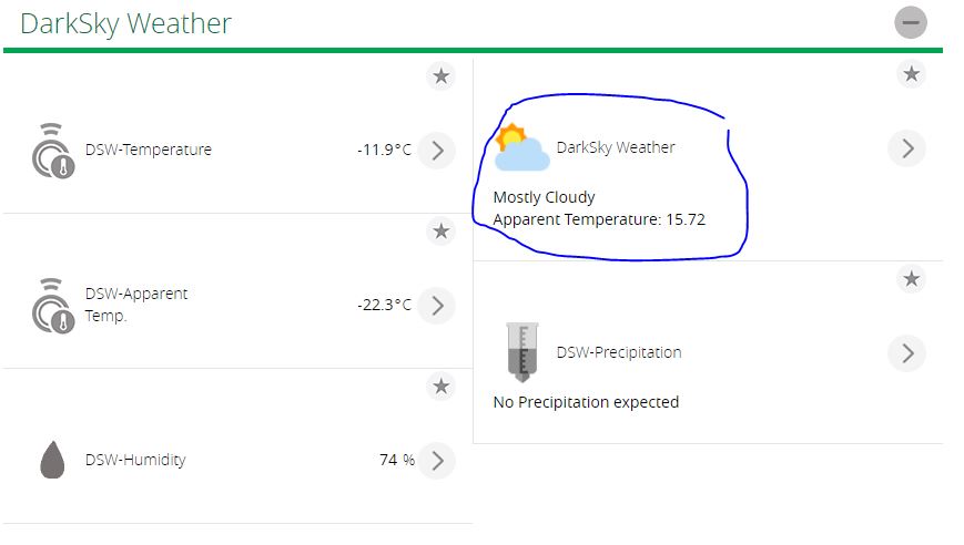

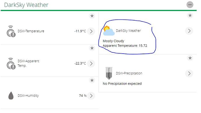

Capture
Hi @notchy,
Geese it’s cold where you are at :slight_smile:
In the plugin settings, have you specified that at least the One Day forecast is to be included? It will not populate the Tomorrow values of you selected No forecast.
Cheers Rene

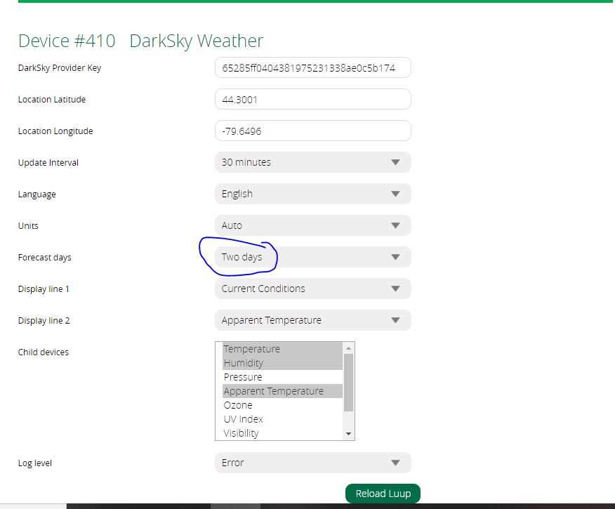

I have it set for 2 days, which should be enough to bring up the data.
Where can I view logs to see if the data is being pulled in for tomorrow’s temperatures?
Capture
Hi notchy,
You can look at the Advanced tab and the Variables. You the should see many Today
, Tomorrow
, anf Forecst.3
 values with your settings.
Cheers Rene
