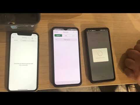

If you’d like to see our test at the office, here’s the first video when we’ve added the device at 3:25 pm on 8/17/2021
And the second one at 4:09 pm on 8/17/2021
