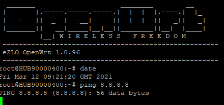

I connected to my Ezlo Plus via SHH
With Internet Connection:
I then blocked the Ezlo Plus on my router so it has no Internet access.
The Ezlo Plus hub then started pulsing with an Orange light.
I then rebooted the Ezlo Plus hub via a SSH command and connected back in after the reboot.
The date and time is still correct with no Internet access which is very promising if it stays that way.
I also tried to ping a Google DNS server it wasn’t able, proving this hub has no Internet access currently.
I am going to leave the Internet access blocked for a while to see what happens ?
If I did this with my Vera Plus it would of lost its time and would be 1st of Jan 2000 I think it use to go to.

Just rebooted the Ezlo Plus hub again and now the time is wrong its actually 9:56am
So maybe it does not have a Real Time Clock onboard.
I don’t remember seeing a battery on the circuit board with the pictures we saw of these hubs when they were cracked open.
@Ezlo_Response_Team
Can we have confirmation why my hub is now showing the incorrect time when it has no Internet connection ?
And can I point it to a local NTP server on my router?
Oh dear its doing weird stuff now, that test scene I setup earlier was a one time scheduled event for 9:35am.
That light has just turned on again as the hub now things its 9:35am.
Its actually 10:09am.
