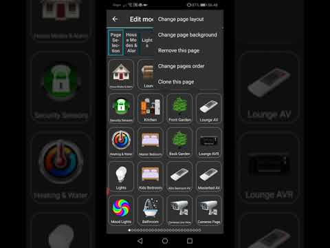

While creating a new dashboard in the Mios app you can select from different lay outs (similar to imperihome)
Hopefully they will expand on the available grid layouts and number of tiles on each layout, far too few currently.
Depends on your screen size, I think.
Only for larger (tablet) screens from 8" and up more icons is helpful.
Looks to me that current design is for phones only. Maybe the devteam can also take into account that tablets have larger screens.
Ezlo need far more page layout choices, what they have currently isn’t going to be good enough.
Here are the all the layouts in Imperihome and even then there was sometimes pages with not just the right amount of widget holder places.
