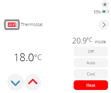

There is a problem dispaying the right set temperature. I’ve got time triggered scenes to adjust the temperature which run smoothly but the displayed set temperature doesn’t update.
Set temperature is 21°C and with 20.9°C the Spirit adjusts correct. But Vera shows still 18°C as set temperatur even though it set it itself by scene.

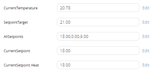

I took a look at the variables. That seem to be indeed the problem:
The scene configures the SetpointTarget correct, but Vera shows CurrentSetpoint or CurrentSetpoint Heat. So it’s a bug in the firmware?

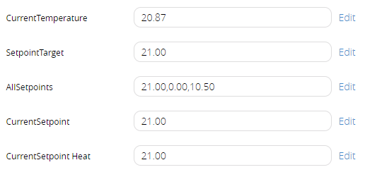

Vera should immediately get response of the themostat when the command is sent via FLiRS and update all other variables. It does work, when I set the temperature manually or if I run the scene manually. But If the scene runs automatically by schedule these variables seem to not update.
Scene run manual:
