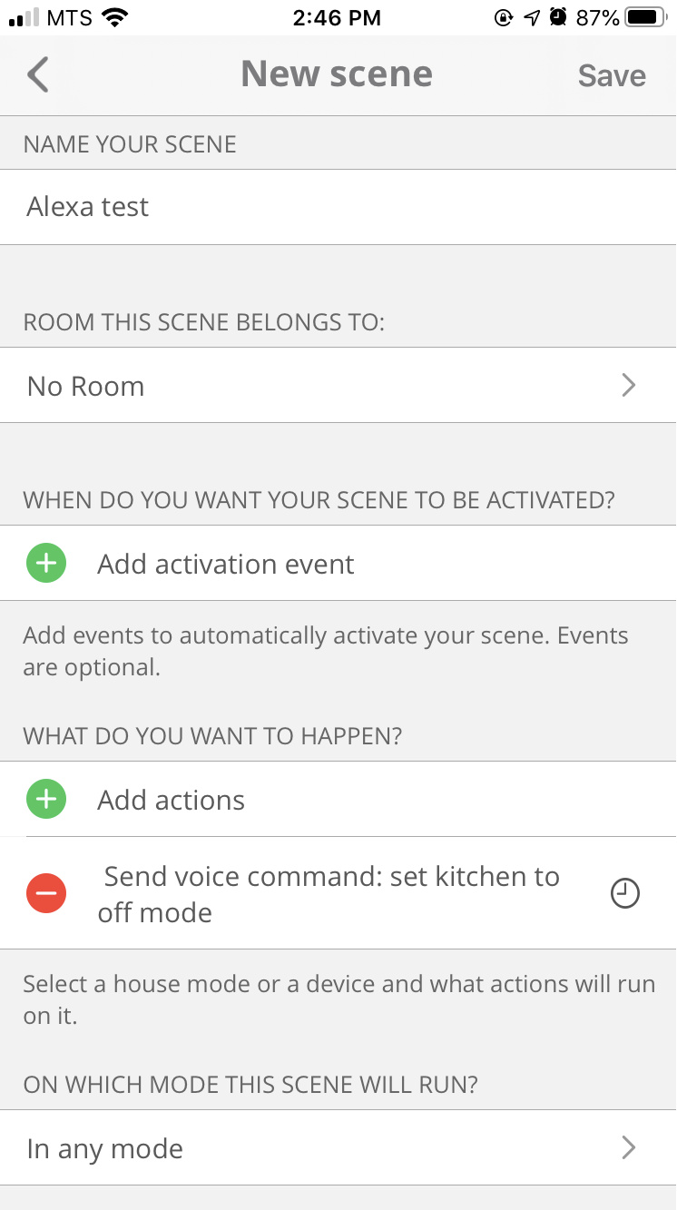

Create a scene as follows:
Action: Ezlo VOI with Amazon Alexa
Saving the scene results in the spinning icon for 5-7 seconds, then returns to an empty scene listing, no scene created.
Alexa is correctly setup as I can manually “Chat with Amazon Alexa” and it works.
Action: turn on zwave dimmer
The action text is blank. This was the dimmer that was selected:
Same results when saving the scene - spinning icon, returns to empty scene listing, no scene created.
I’ve replicated these results on both hardware platforms.
Dear @af20902 and @dgdev,
It looks like we have a bug on scene creation on app version 3.44 (7), and we will look into details as of Monday. We will get back to you through this thread.

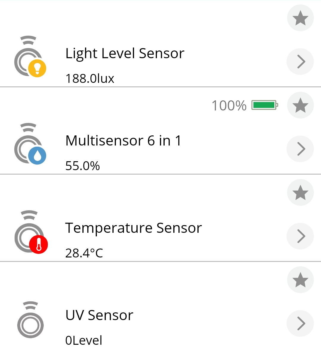

I’ve successfully included a Aeotec Multisensor 6 as Generic Z-Wave device. But there is no motion sensor (included/excluded several times).
I don’t know if it makes a different, but I’ve included in secure mode (normal mode not yer tested).

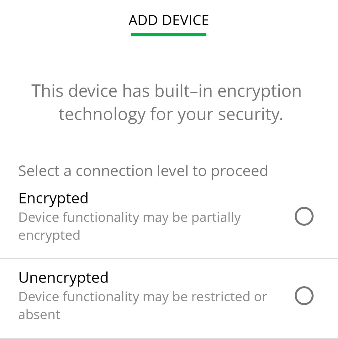

Eurotronic Spirit thermostat also included fine as generic device. There was a new menu during inclusion letting me choose encrypted or unencrypted connection level:
I’ve chosen the encrypted one. The set temperature made at the thermostat is displayed almost immediately in the app. The other way (temperature set in app → thermostats display) I think also worked (I’m not sure about that anymore). I’ve created time triggered scenes for day/night with different temperatures and tested them. The termostat made some sounds, but the display of the termostat and the app didn’t change. Setting temperature via app didn’t work too even if the message “Command sent” was displayed.
I’ll give the unencrypted connection a try the next time…
Happy to see this! Vera firmware can’t do this.
Indeed positive, bt does it work?
And what are pros and cons of both methods?
I will give you an example.
I had a rather excellent Z-Wave motion sensor. A Neo CoolCam one in fact, the best Z-Wave motion sensor I have had and I’ve tried many!
However said Neo motion sensor does not support S2 Security and is included in to Vera unencrypted or insecure.
I then had a Fibaro Dimmer 2 module that does support S2 and was included in to Vera as encrypted or secure.
I wanted to use native Z-Wave association groups, so that when the Neo motion sensor was tripped it would then turn on the Fibaro dimmer 2. Simple right? Wrong.
The Fibaro Dimmer 2 can only be controlled by a motion sensor that is also S2 secure.
In this example, if Vera FW had supported this feature, which it does not, I would have included the Fibaro Dimmer 2 in unencrypted mode and then my also unencrypted Neo motion sensor could of controlled the Fibaro Dimmer 2 via native Z-Wave association.
This is the only reason I can think of for wanting to be able to include devices unencrypted.
