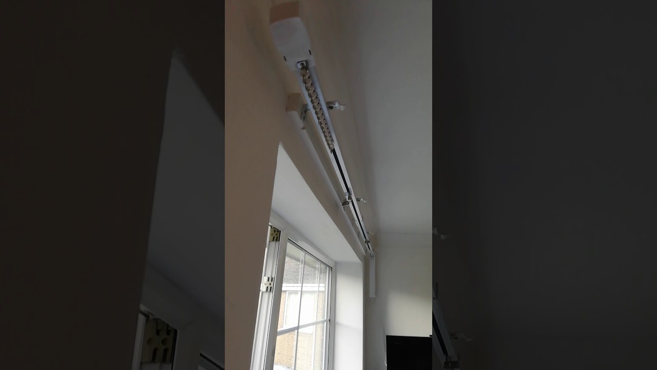

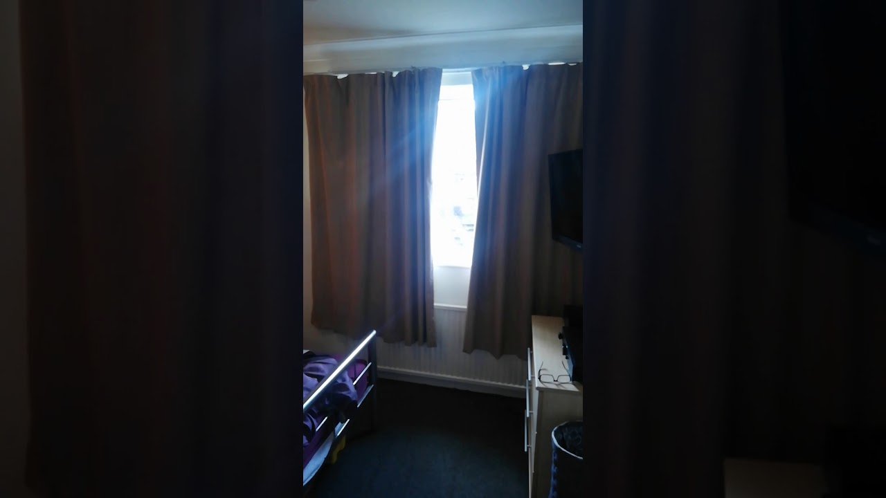

Finally got around to installing this curtain track and motor today. It’s working fine with my Vera Plus, the motor just sorted itself out with the track limits, so didn’t need to set anything in the end.
Can manually pull the curtains also to start the motor opening or closing etc. The motor and track is very quiet.
