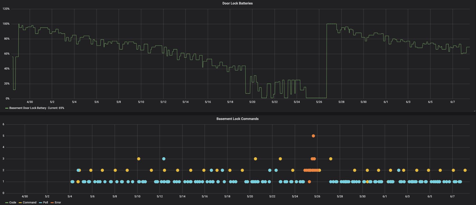

Taking a closer look at a single lock with very little activity, my basement door lock:
We can see that I am getting about a month life on a battery with a small amount of activity. I average two commands and 1 poll per day. The commands are the arming of the alarm instructing the door to lock - the door is almost always locked, so it should just need to wake up and indicate success. The poll I believe follows the command to lock.
I have polling set to 0 for all of these locks. I am a bit out of ideas on what else to try? Could I have multiple defective lock modules? Is 1 month the right life for a door lock that doesn’t really have to do very much? Could I have some sort of routing issues where traffic is passing through these locks (I can’t imagine why that would be). What is the next step to diagnose this?
