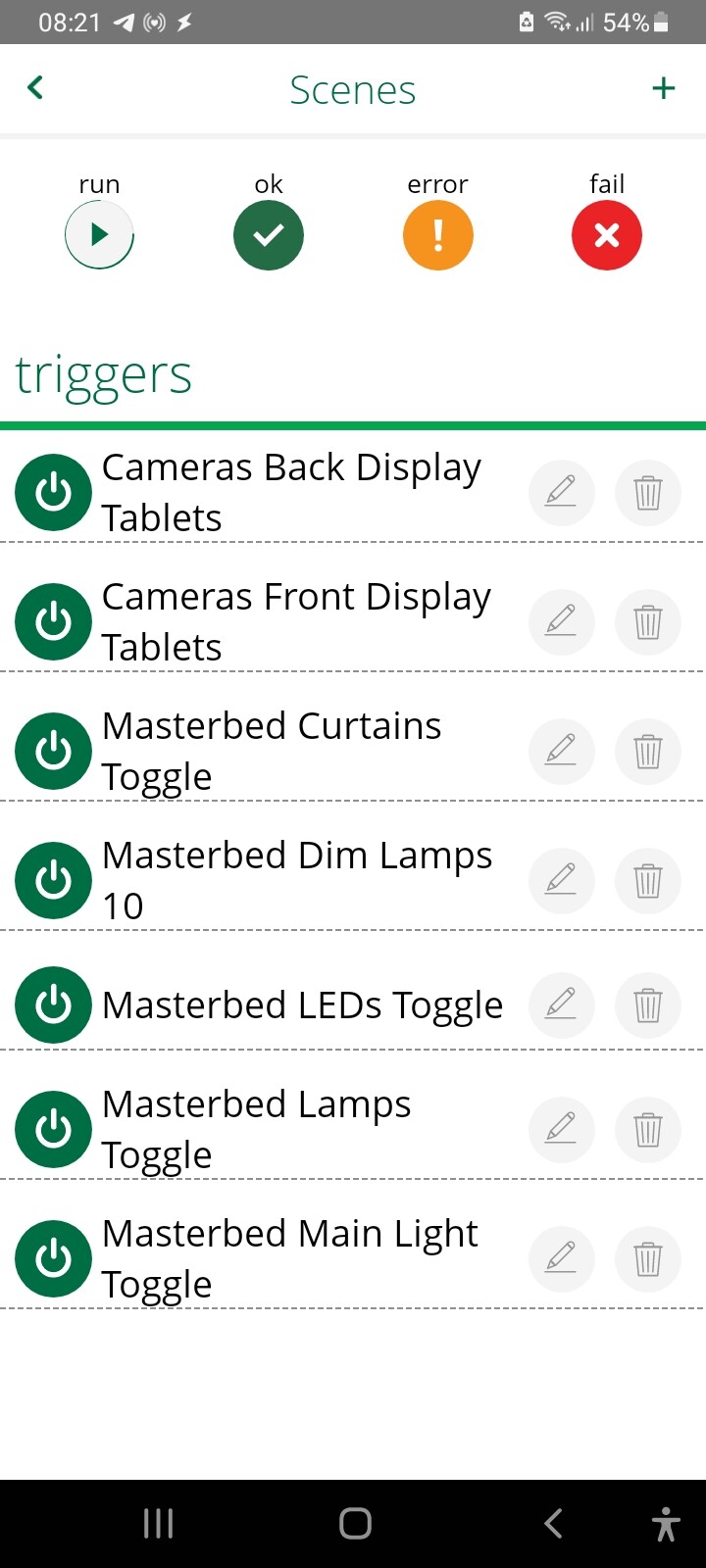

Ok this is interesting in the latest dev build MIOS Android app when going into a Scene Controller device paired to the Ezlo Plus I can actually see which Meshbots I previously setup button press triggers for manually.
However I cannot see a way in here to assign a different Meshbot scene to a button?
If I press the Plus button I just get a new Meshbot scene creation page, which is not what I expected.
Previously in the other Vera mobile app I dont recall you could see this list of assigned scenes.
Looking now in the Vera mobile app I see a similar thing to the MIOS app.
But again no way to assign a button to an existing scene?

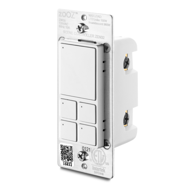

I’ve been horsing around with a ZooZ Zen32 I just received, using it with my VeraEdge.
I’ve been examining the state of the Zen32’s sl_CentralScene and sl_CentralSceneAttr. Their values can be used easily in Reactor, e.g., to trigger events.
Here’s what I’ve found
sl_CentralScene is indicative of WHICH button is/was pressed. It appears to change state whenever a button is pressed, and it remains in that state forever until a different button is pressed. It takes the following values:
- Big button = 5
- Small buttons
- upper-left=1
- upper-right=2
- lower-left=3
- lower-right=4
sl_CentralSceneAttr is indicative of the “type” of button press. For example, “one quick press” or “press-then-hold-for-a-period-then-release” or “two quick presses” through “five quick presses”. It takes these values:
- Single tap = 0
- Double tap = 3
- Triple tap = 4
- Quad tap = 5
- Quint tap = 6
- Press-and-hold:
  - reports the value 2 while the button is held pressed, then
  - changes to =1 when it's released
A value of “1” would indicate the last press was a press-and-hold. A value of “2” would indicate that a “press-and-hold” is in progress and has yet to be released.
The values 0,3,4,5,6 need no further explanation.
