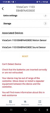

In the Android Mios app, I saw this Reset option.
Screenshot_20240722_173916_MiOS
And I then held down the reset button, until the Green “Status” light on the RJ45 connector stopped flashing.
Screenshot_20240722_173925_MiOS
However after that it just took me back to the first screen (first screenshot) and didnt appear to have done anything?
I still cant play this cameras feed in the Mios app.
Screenshot_20240722_174712_MiOS
This Reset process did not mention or ask me anything about the Wifi network the camera is to be connected too.
