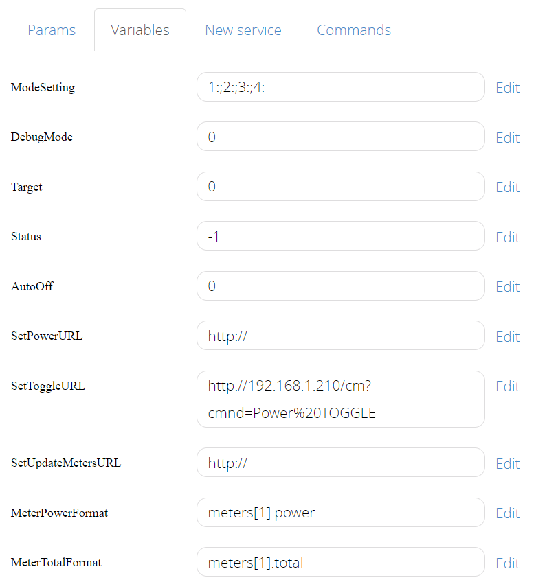

I have installed this plugin from my hub under apps/install apps. I entered the IP address if my tasmota sonoff basic but it does not switch on or off the device. I set the toggle URL in the variables tab but nothing. What else do I need to do to get it to work.
Many thanks
The url are enough. Post your variables, so I could double check them.
I’m just at work so will grab some screen shots as soon as I can.
I installed the app via the Vera unit. Are there any other files I need to upload, or is the app all I need?
Many thanks
App is enough. I usually update it on GitHub first, but the latest version should be on AppStore as well. It’s very easy to setup, so it’s strange you’re having troubles, but we’ll take a look at the vars and fix it :wink:
Sonoff1Sonoff2
you just need to set altro SetPowerUrl and SetPowerOffUrl, as you did for SetToggleUrl.
