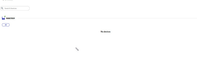

Well today 9-10-2023 all meshbots are totally filled in, and it makes no difference I could just as easily not have meshbots as have them.
Also, today my controller will not go into Inclusion mode, just sits there with the Aqua colored light ON.
I am using my Android phone to log into my Vera account but makes no difference, so now what.
You worry about one meshbot not be configured correctly, well here is your software not functioning .
Here you want pictures of a piece of non-functioning software 1.64.2

This is not replicating on our end.
Could you please try deleting the browser cache and the Indexed Database?
Go to your browser’s Developers options (Chrome: Press F12 or Ctrl+Shift+I) > Application > IndexedDB > ezlodashboard > Delete database.
ezgif.com-video-to-gif (6)
@Alvaro_Ochoa When did you record that video ? According to developer Efe the IndexedDB is no longer present or being used.
I see no such IndexedDB anymore.
You could try instead clicking the “Clear Site Data” button though.

You are correct. Still, his interface problems (empty backup list or devices list) are likely related to the browser.
Yes I would try deleting all browsing data from the browser and try again.
To do this in Chrome
I have just checked and I also have similar issues now with the Backups not being listed. I have asked the developers to check it out.
I recorded this screen about 3 or 4 days ago.
