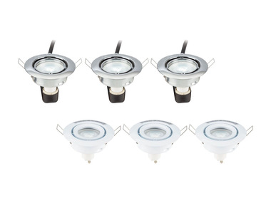

I tried to connect some cheap zigbee devices to my Vera plus.
I could pair them as a generic Zigbee device, and can control them. That is to say… can only turn the lights on or of.
It should also be possible to dim the lights and change the color.
I contacted Vera Support, and they could help me If we can find the XML and Json files.
But unfortunately I can not find them.
I even bought the gateway that Lidl sells, that works fine with the bulb, but misses some functionality that my Vera Plus has. (automation)
I was hoping to find the XML and Json files in the gateway, but cannot login to it.
So I probably need someone who can create the XML file or knows the settings to configure it in Vera Plus.
Anyone can help me?
