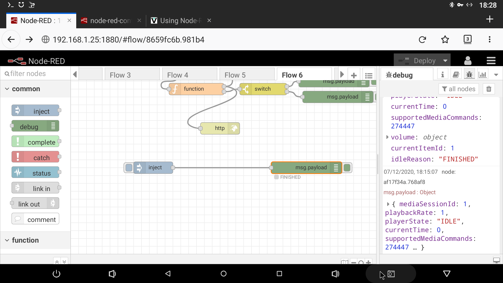

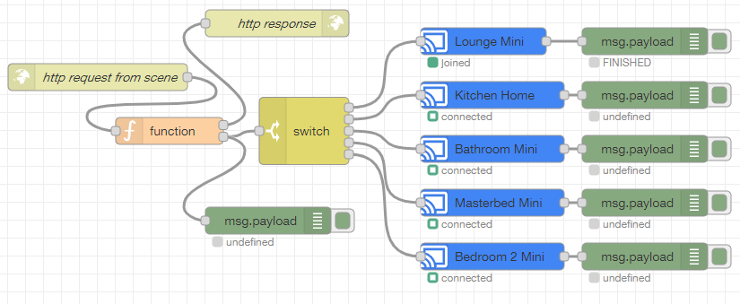

when you run tts at end does it say “finnished” under the debug node? not the debug window.
you can add a date and time too so you know when it last ran, you can have a 32 letter message. on my http request and mqtt i show time and status codes etc
After running a TTS HTTP command this is the last entry in the debug
{"mediaSessionId":1,"playbackRate":1,"playerState":"IDLE","currentTime":0,"supportedMediaCommands":274447,"volume":{"level":1,"muted":false},"currentItemId":1,"idleReason":"FINISHED"}
not in the debug window, under the debug node itself.
like above
Yes it does
The others say undefined
How do you add date and time ?
Ok
[{"id":"af17f34a.768af8","type":"debug","z":"8d22ae29.7df6d","name":"","active":true,"tosidebar":true,"console":false,"tostatus":true,"complete":"payload","targetType":"msg","statusVal":"        (payload.idleReason = \"FINISHED\" ? \"Done\" : \"\")\t  & \" | \" & $moment().format(\"ddd HH:mm:ss\")\t","statusType":"jsonata","x":600,"y":2420,"wires":[]}]
edit/ typo

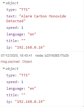

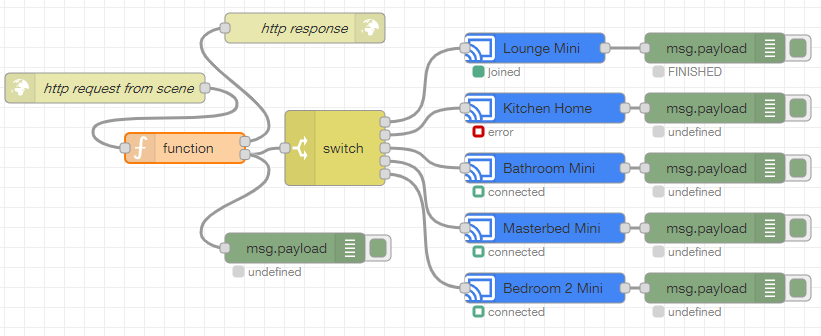

OK there is a problem with sending to more than one Google Home Speaker:
http://192.168.0.4:1880/sceneTrigger?message=Alarm%20Carbon%20Monoxide%20Detected&ip=192.168.0.16|192.168.0.19
It plays on the Lounge Mini OK but the Home speaker in the Kitchen it doesn’t play the TTS but it does make the ding sound as if it is about to do it.
An error can be seen on the Kitchen speaker
Error: Unknown command
Looks like the second speaker isn’t getting the text :sleepy:
Debug node looks like this now:
updated function
[{"id":"4405a5e2.b6263c","type":"function","z":"8d22ae29.7df6d","name":"","func":"var IPS = msg.payload.ip.split(\"|\");\nvar message =msg.payload.message;\nfor (var i in IPS) { \nmsg.payload = {\n    type: \"TTS\",\n    text: message,\n    speed: 1, // optional to adjust TTS speed, defaults to 1\n    language: \"en\", // optional to set TTS language, default to en\n    title:\"\",\n    ip: IPS[i]\n    }\n\nnode.send([null, [msg]]);\n}\nmsg.payload = \"ok\"; // the response message\nreturn [msg];\n","outputs":2,"noerr":0,"initialize":"","finalize":"","x":320,"y":2220,"wires":[["9d497085.252fe8"],["5694dfbe.42dd8","d46f5c71.d2de1"]]}]
Yep, when finnished it will say done and if not finished will be blank.
would you like a green circle when done and red when not?
Damn your fast !
That works now both speakers speak out the TTS.
I’ve tested it with four Home speakers and they all say the TTS now.

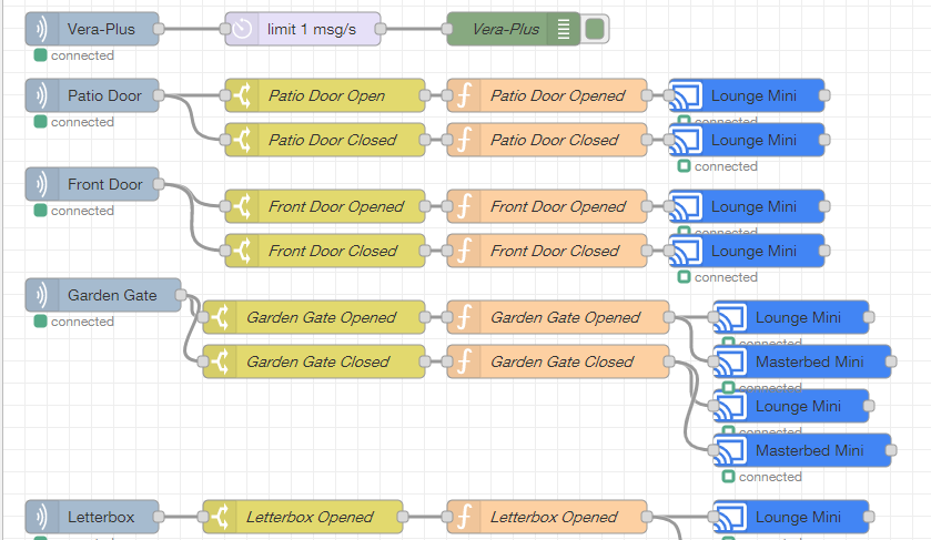

I also had some static TTS announcements based on device state using the MIOS node etc.
Probably not the best way to do it, but I’ve had to add a function and the replacement Castv2 nodes.
The functions are just like this:

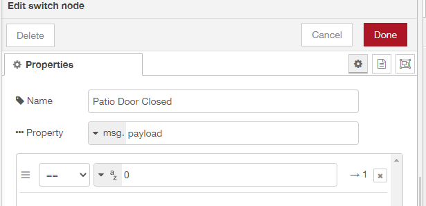

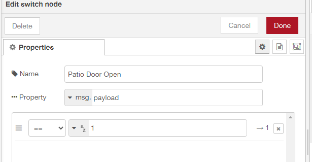

The Switch nodes are the same as what they were before, just looking for a 1 or 0 for the device being tripped or not tripped etc.

This is how they looked with the old Cast node:
Export the flow i can probably slim that lot down
are they mios in nodes?
One(possibly) in node one function and into the same switch node for the scenestriggers.
infact export the new tts flow to, and i will combine them.

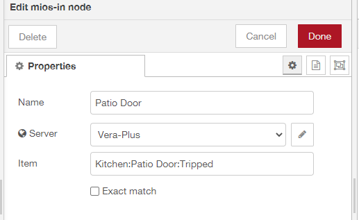

I have all my sensors in one room called sensors. i can then refer to them in mios node, and not get any other switch info.
Here is the new TTS flow

try this i have added the two sensors in the function.
[{"id":"eddb7aa9.886be","type":"mios-in","z":"66b3988b.4a2ea8","name":"Front Door","server":"1de4bdab.459a8a","item":"Porch:Front Door:Tripped","exact":false,"x":90,"y":440,"wires":[["e81dc498.0a1308"]]},{"id":"e81dc498.0a1308","type":"function","z":"66b3988b.4a2ea8","name":"","func":"let sensors={\n    \"Kitchen:Patio Door:Tripped\":{\n        \"ips\":\"192.168.0.16|192.168.0.19\",\n        \"message\":[\"Patio Door Closed\",\"Patio Door Opened\"],\n        \"volume\":35\n    },\n    \"Porch:Front Door:Tripped\":{\n        \"ips\":\"192.168.0.16|192.168.0.19\",\n        \"message\":[\"Front Door Closed\",\"Front Door Opened\"],\n        \"volume\":35\n    },\n    \"Porch:Letterbox:Tripped\":{\n        \"ips\":\"192.168.0.16|192.168.0.19\",\n        \"message\":[\"null\",\"Letter box Opened\"],\n        \"volume\":35\n    }\n}\nlet sensor = sensors[msg.topic];\nif(sensor[\"message\"][msg.payload] !== \"null\"){\nmsg.payload = {\n    \"message\": sensor[\"message\"][msg.payload],\n    \"ip\": sensor[\"ips\"],\n    \"volume\": sensor[\"volume\"]\n    }\nmsg.sensor = true;\nreturn msg;\n}else{\n    return;\n}","outputs":1,"noerr":0,"initialize":"","finalize":"","x":270,"y":380,"wires":[["a5e81c85.6cb888"]]},{"id":"8a0ab9ca.46477","type":"mios-in","z":"66b3988b.4a2ea8","name":"Patio Door","server":"1de4bdab.459a8a","item":"Kitchen:Patio Door:Tripped","exact":false,"x":90,"y":380,"wires":[["e81dc498.0a1308"]]},{"id":"a5e81c85.6cb888","type":"function","z":"66b3988b.4a2ea8","name":"","func":"var IPS = msg.payload.ip.split(\"|\");\nvar message =msg.payload.message;\nfor (var i in IPS) { \nmsg.payload = {\n    type: \"TTS\",\n    text: message,\n    ip: IPS[i]\n    }\n\nnode.send([null, [msg]]);\n}\nif(!msg.sensor){\nmsg.payload = \"ok\"; // the response message\nreturn [msg];\n}else{\n return;\n}\n","outputs":2,"noerr":0,"initialize":"","finalize":"","x":200,"y":160,"wires":[["ac7159a9.0806d8"],["67b423dd.7a9a1c"]]},{"id":"e1e73f8f.e66748","type":"mios-in","z":"66b3988b.4a2ea8","name":"Letterbox","server":"1de4bdab.459a8a","item":"Porch:Letterbox:Tripped","exact":false,"x":90,"y":500,"wires":[["e81dc498.0a1308"]]},{"id":"e1c51dd3.ce0e2","type":"http in","z":"66b3988b.4a2ea8","name":"http request from scene","url":"sceneTrigger","method":"get","upload":false,"swaggerDoc":"","x":120,"y":100,"wires":[["a5e81c85.6cb888"]]},{"id":"ac7159a9.0806d8","type":"http response","z":"66b3988b.4a2ea8","name":"http response","statusCode":"200","headers":{},"x":320,"y":40,"wires":[]},{"id":"67b423dd.7a9a1c","type":"switch","z":"66b3988b.4a2ea8","name":"","property":"payload.ip","propertyType":"msg","rules":[{"t":"eq","v":"192.168.0.16","vt":"str"},{"t":"eq","v":"192.168.0.19","vt":"str"},{"t":"eq","v":"192.168.0.20","vt":"str"},{"t":"eq","v":"192.168.0.21","vt":"str"},{"t":"eq","v":"192.168.0.24","vt":"str"}],"checkall":"true","repair":false,"outputs":5,"x":400,"y":160,"wires":[["a71a4aab.f1a4c8"],["512ec525.ee0f4c"],["f26c9efc.a34d58"],["266bf474.3e3fc4"],["b43a5935.deb66"]]},{"id":"1de4bdab.459a8a","type":"mios-server","z":"","name":"Vera-Plus","host":"192.168.1.11","port":"3480"}]
