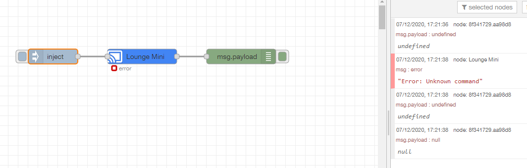

There is like four main things it puts in to the debug:
{"mediaSessionId":1,"playbackRate":1,"playerState":"IDLE","currentTime":0,"supportedMediaCommands":274447,"volume":{"level":1,"muted":false},"activeTrackIds":[],"media":{"contentId":"https://translate.google.com/translate_tts?ie=UTF-8&client=tw-ob&tl=en&q=Something%20to%20say","contentType":"audio/mp3","streamType":"BUFFERED","metadata":{"metadataType":0,"title":"tts","images":[{"url":"https://nodered.org/node-red-icon.png"}]},"mediaCategory":"AUDIO"},"currentItemId":1,"extendedStatus":{"playerState":"LOADING","media":{"contentId":"https://translate.google.com/translate_tts?ie=UTF-8&client=tw-ob&tl=en&q=Something%20to%20say","contentType":"audio/mp3","streamType":"BUFFERED","metadata":{"metadataType":0,"title":"tts","images":[{"url":"https://nodered.org/node-red-icon.png"}]},"mediaCategory":"AUDIO"},"mediaSessionId":1},"repeatMode":"REPEAT_OFF"}
{"mediaSessionId":1,"playbackRate":1,"playerState":"PLAYING","currentTime":0,"supportedMediaCommands":274447,"volume":{"level":1,"muted":false},"activeTrackIds":[],"media":{"contentId":"https://translate.google.com/translate_tts?ie=UTF-8&client=tw-ob&tl=en&q=Something%20to%20say","contentType":"audio/mp3","streamType":"BUFFERED","metadata":{"metadataType":0,"title":"tts","images":[{"url":"https://nodered.org/node-red-icon.png"}]},"mediaCategory":"AUDIO","duration":1.464,"tracks":[{"trackId":1,"type":"AUDIO"}],"breakClips":[],"breaks":[]},"currentItemId":1,"items":[{"itemId":1,"media":{"contentId":"https://translate.google.com/translate_tts?ie=UTF-8&client=tw-ob&tl=en&q=Something%20to%20say","contentType":"audio/mp3","streamType":"BUFFERED","metadata":{"metadataType":0,"title":"tts","images":[{"url":"https://nodered.org/node-red-icon.png"}]},"mediaCategory":"AUDIO","duration":1.464},"autoplay":true,"activeTrackIds":[],"orderId":0}],"repeatMode":"REPEAT_OFF"}
{"mediaSessionId":1,"playbackRate":1,"playerState":"PLAYING","currentTime":1.107177,"supportedMediaCommands":274447,"volume":{"level":1,"muted":false},"activeTrackIds":[],"currentItemId":1,"repeatMode":"REPEAT_OFF"}
{"mediaSessionId":1,"playbackRate":1,"playerState":"IDLE","currentTime":0,"supportedMediaCommands":274447,"volume":{"level":1,"muted":false},"currentItemId":1,"idleReason":"FINISHED"}
try this as i had not used capitals
[{"id":"5b00ab01.0fe374","type":"inject","z":"8d22ae29.7df6d","name":"","props":[{"p":"payload"},{"p":"topic","vt":"str"}],"repeat":"","crontab":"","once":false,"onceDelay":0.1,"topic":"","payload":"{\"type\":\"VOLUME\",\"volume\":100}","payloadType":"json","x":100,"y":2340,"wires":[[]]}]
That works and changes the volume on the Google Home Mini.
I also tried 10 and that turns it down again.

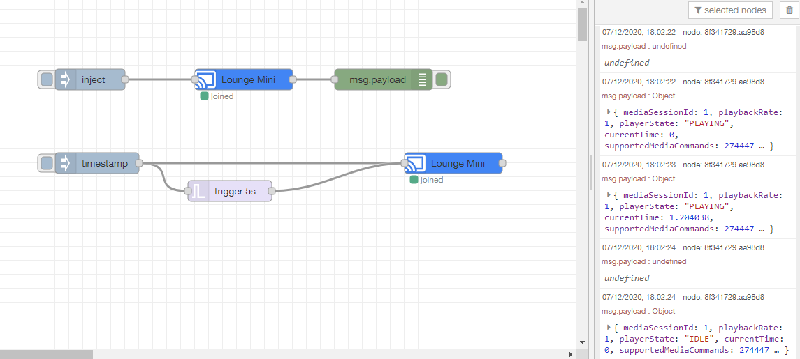

can you add cast node where debug is and then inject, does it speak at 70 then set volume to 35?
[{"id":"5b00ab01.0fe374","type":"inject","z":"8d22ae29.7df6d","name":"","props":[{"p":"payload"},{"p":"topic","vt":"str"}],"repeat":"","crontab":"","once":false,"onceDelay":0.1,"topic":"","payload":"{\"type\":\"VOLUME\",\"volume\":70}","payloadType":"json","x":50,"y":2420,"wires":[["ba0e539b.3fb8a8","af17f34a.768af8"]]},{"id":"ba0e539b.3fb8a8","type":"trigger","z":"8d22ae29.7df6d","name":"","op1":"{\"type\":\"TTS\",\"text\":\"Something to say\"}","op2":"{\"type\":\"VOLUME\",\"volume\":35}","op1type":"json","op2type":"json","duration":"500","extend":false,"units":"ms","reset":"","bytopic":"all","topic":"topic","outputs":1,"x":280,"y":2460,"wires":[["af17f34a.768af8"]]},{"id":"af17f34a.768af8","type":"debug","z":"8d22ae29.7df6d","name":"","active":true,"tosidebar":true,"console":false,"tostatus":false,"complete":"false","statusVal":"","statusType":"auto","x":600,"y":2420,"wires":[]}]
Nope, it seems to turn it up then turn it down and then say the TTS.
can you change the time setting in the trigger to 2 seconds
5 seconds works with that particular phrase “Something to say”.
However longer TTS announcements may need more time.
Try this one do not reuse any of the old one.
[{"id":"5b00ab01.0fe374","type":"inject","z":"8d22ae29.7df6d","name":"","props":[{"p":"payload"},{"p":"topic","vt":"str"}],"repeat":"","crontab":"","once":false,"onceDelay":0.1,"topic":"","payload":"","payloadType":"date","x":70,"y":2420,"wires":[["ba0e539b.3fb8a8","af17f34a.768af8"]]},{"id":"ba0e539b.3fb8a8","type":"trigger","z":"8d22ae29.7df6d","name":"","op1":"{\"type\":\"TTS\",\"text\":\"Something to say\"}","op2":"{\"type\":\"VOLUME\",\"volume\":35}","op1type":"json","op2type":"json","duration":"5","extend":false,"units":"s","reset":"","bytopic":"all","topic":"topic","outputs":1,"x":260,"y":2460,"wires":[["af17f34a.768af8"]]},{"id":"af17f34a.768af8","type":"debug","z":"8d22ae29.7df6d","name":"","active":true,"tosidebar":true,"console":false,"tostatus":false,"complete":"false","statusVal":"","statusType":"auto","x":600,"y":2420,"wires":[]}]
I will add 2 seconds per word.
That one doesn’t change the volume either way at all it just says the TTS.
I takes a few seconds for it to connect to the Home speaker before it even starts speaking, that is why 5 seconds worked on that last test.
It was long enough for it to connect say the phrase at the increased volume and then for it to lower the volume again.
I was experimenting with the meta data to see if Volume could be passed
try this
[{"id":"5b00ab01.0fe374","type":"inject","z":"8d22ae29.7df6d","name":"","props":[{"p":"payload"},{"p":"topic","vt":"str"}],"repeat":"","crontab":"","once":false,"onceDelay":0.1,"topic":"","payload":"","payloadType":"date","x":70,"y":2420,"wires":[["ba0e539b.3fb8a8","af17f34a.768af8"]]},{"id":"ba0e539b.3fb8a8","type":"trigger","z":"8d22ae29.7df6d","name":"","op1":"{\"type\":\"TTS\",\"text\":\"Something to say\",\"metadata\":{\"volume\":70}}","op2":"{\"type\":\"VOLUME\",\"volume\":35}","op1type":"json","op2type":"json","duration":"5","extend":false,"units":"s","reset":"","bytopic":"all","topic":"topic","outputs":1,"x":260,"y":2460,"wires":[["af17f34a.768af8"]]},{"id":"af17f34a.768af8","type":"debug","z":"8d22ae29.7df6d","name":"","active":true,"tosidebar":true,"console":false,"tostatus":false,"complete":"false","statusVal":"","statusType":"auto","x":600,"y":2420,"wires":[]}]
Same it says the TTS but the volume is not changed either way at all.
I am seeing a lot of these Undefined messages in the debug, even though it works and says the TTS on the speaker.
OK it was worth a shot, i will add a volume to function.
The castv2 from docs "output the current google cast device platform state or cast application state " so i would not worry when running just disable the debug output by pressing the button, you can also view info in the node status. add this debug to your cast nodes and run a tts
[{"id":"af17f34a.768af8","type":"debug","z":"8d22ae29.7df6d","name":"","active":true,"tosidebar":true,"console":false,"tostatus":true,"complete":"payload","targetType":"msg","statusVal":"payload.idleReason","statusType":"msg","x":600,"y":2420,"wires":[]}]
OK I’ve added that debug node to all the castv2 nodes.
