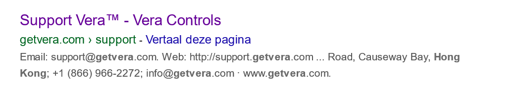

Or could have something to do with the situation in Hong Kong? Not sure if Vera is run/located there. I see on the current website the address is in US now, but I swear I have seen a Hong Kong address there before:
:rofl: https://getvera.com/blogs/our-blog/a-letter-from-the-ceo :joy:
Pretty sure they’re US but…
:wink:
Just found this:
Ezlo is headquartered in Clifton, New Jersey, with offices in Ukraine, Romania, and Colombia.
