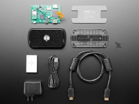

This looks like it could be interesting.. - http://www.kosagi.com/blog/
NeTV ??
http://wiki.chumby.com/index.php/What_is_NeTV
It’s the sort of thing that I had in mind.

https://www.adafruit.com/products/609
Not sure if this is available in the UK, but if anyone has one or is thinking of it I would be interested to hear from them..

Funny timing and small world in the HA community I suppose. I just got a Vera3 which I am going to start to use as my primary HA solution. Anyway, that’s me in the first post asking about NeTV and Homeseer.
Here’s what I know about the device:
  1. It can definitely receive events and overlay them onto just about any HDMI source. This is available almost out of the box.
  2. It’s a Busybox based Linux system.
  3. Everything is JS and html – basically the overlays are rendered through a browser, without all the UI components of buttons and window frames and menus. Just the web content itself.
  4. It would not be totally suitable for “production” without some amount of customization. The device is really a technology platform and not intended to be a finished product for any particular use, although the event system already built into it gets you at least 80% of the way there.
IMO it’s the ideal device for this sort of thing. The price is right and the fact that content is just js and html makes it really easy to do stuff with it. I’m a little ashamed mine’s just sitting here collecting dust and wish I had more time to work on it. The last major hurdle I ran into was that the event system seemed to skip events frequently, and that the Twitter feed display at the bottom was driving my wife crazy. I only had a couple days into messing around with the box so these problems are solvable.
