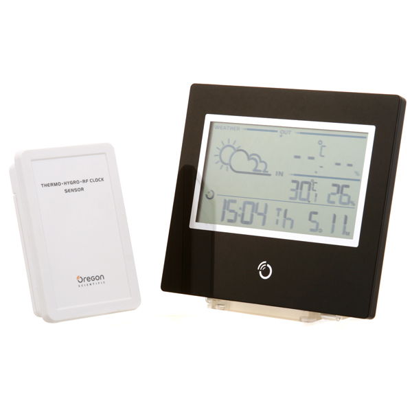

I do indeed have an oregon “bar 800” with the remote sensor “rtgn318”.
If i connect the rfxtrx to my pc, I can read those values. However, values received by the rfxtrx do not match those displayed on the “bar 800”…
Maybe the display is updated less often.
Anyway, it appears that the remote sensor battery was empty for a long time, I suppose the value reported by the plugin was the last saved one.
Since I didn’t realize my oregon was detected by the rfxtrx, i thought the values did come from a sensor built in the rfxtrx. I understand better now.
Thanks lolodomo! :slight_smile:
