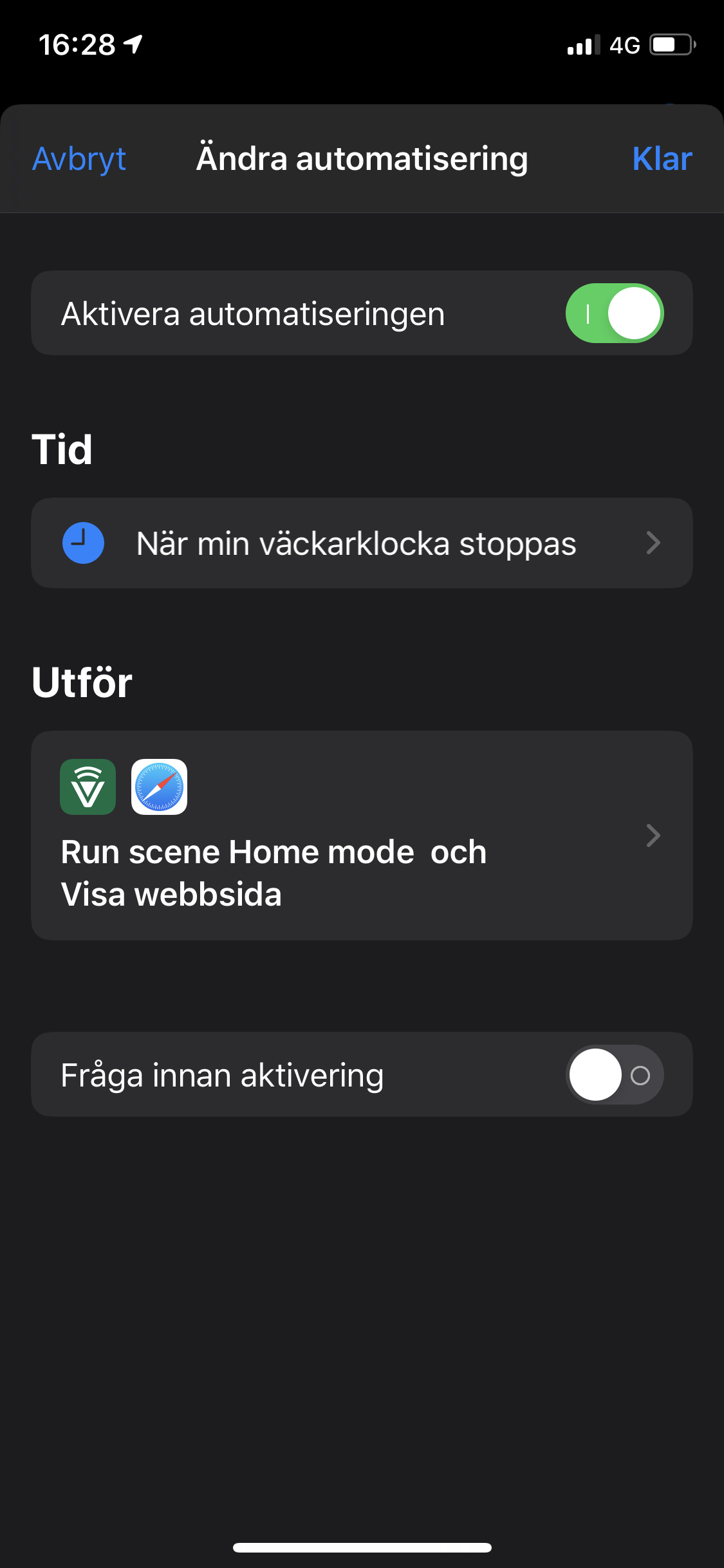

Ok. At home now and Dark as hell!
Did not run home mode scene!
I have noticed a thing
My turn off alarm then turn on scene in Vera has a question that says
Ask for activation. ”On/off”
Automations Don’t seem to have that function…
Strange!!!

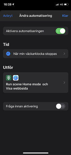

Strange!!!

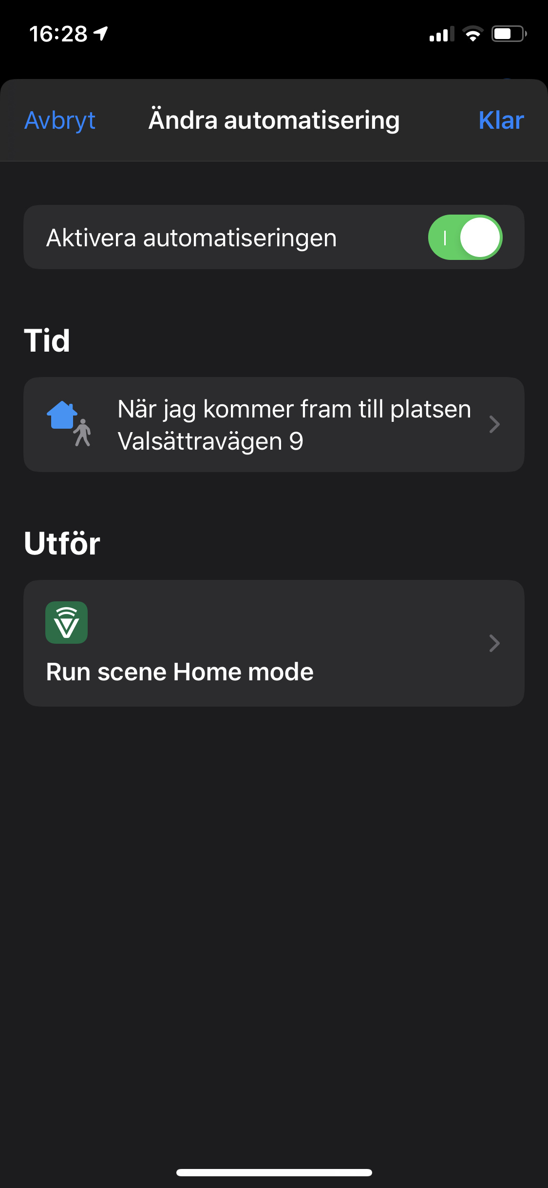

Seriously? Is there somewhere we can read more on that? What sort of automation needs to be run manually?
EDIT
Blow me you’re right:
The following automations cannot be run automatically:
WTAF?
C
Maybe you could try by unmark ”show at run”
Wow that is unfortunate… what’s the point in having an automation when it can’t even run on it’s own.
Very odd. The ‘rationalisations’ are fascinating as well…
