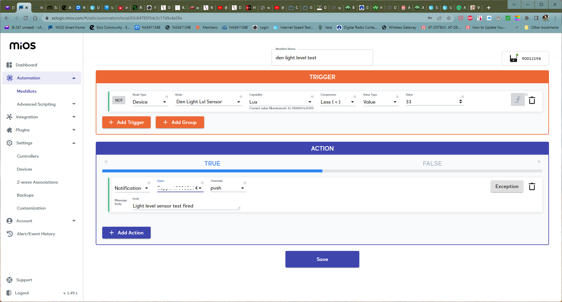

If I try to save this 'bot, it never saves Save button isn’t grayed out
bot not save

This happens to me as well but only, it seems, if I leave the browser tab with Ezlogic running for an extended period before trying to do some Meshbot editing. I find that if I reload the page and then write the Meshbot or make editing changes the save process works fine. I am using Win 11 with Microsoft Edge as the browser.
It just happened again and I had just done a reload
I have seen this problem as well. I find it occurs when you edit a pre-existing meshbot sometimes the save button just stay greyed out after you change things. If I change the name by even one character it then saves replacing the old one. That has been my workaround but its not ideal. I just put an R0.1 at the end of the name and increment it when I have trouble saving.
I also find that if you have a delay on one of your actions and you just change the delay time it doesn’t ever allow you to save it without changing something else like the name. So some sort of bug there that is highly repeatable.
