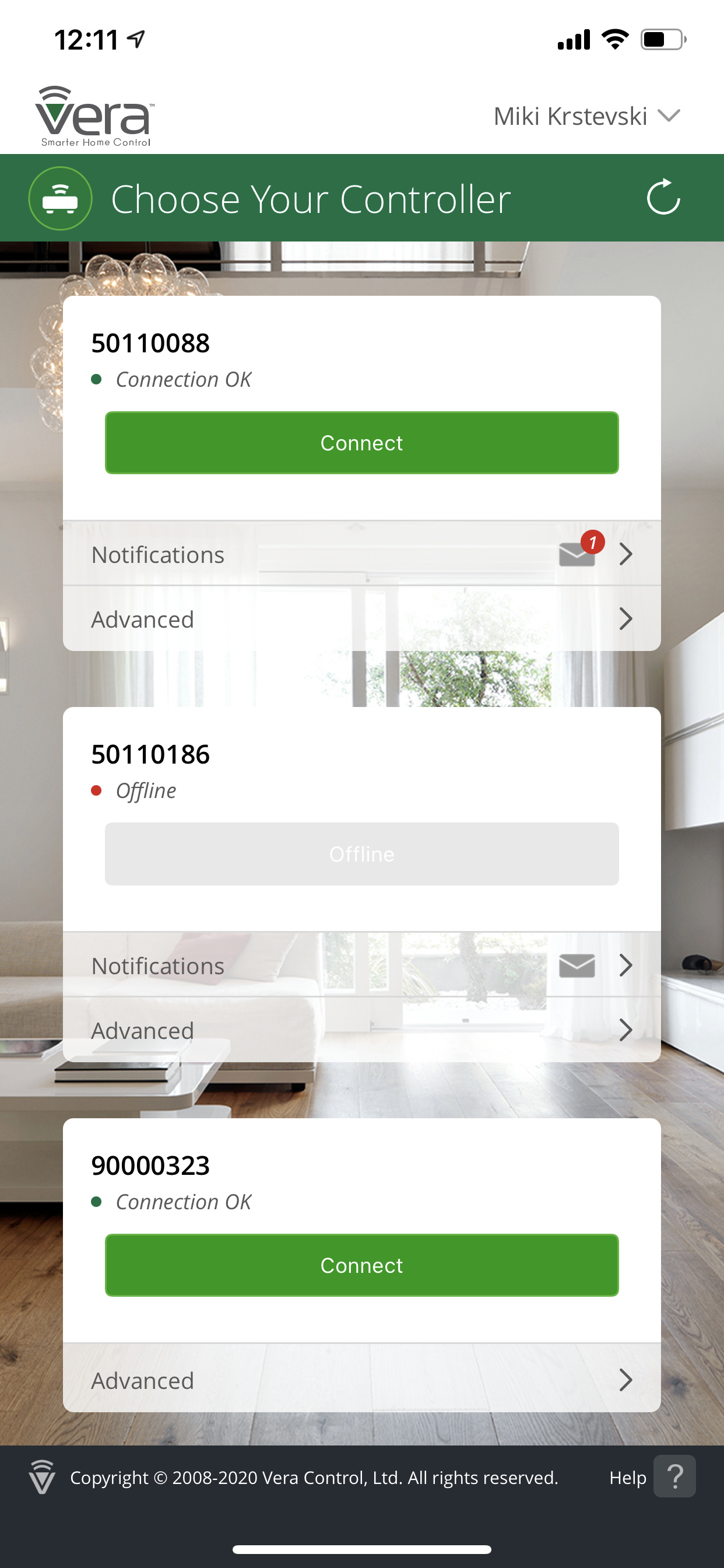

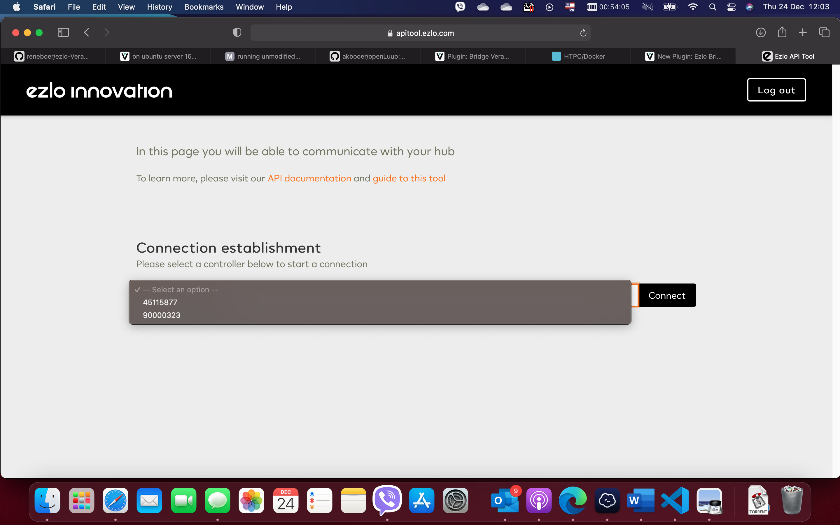

p.s. i have access to controller from app and from ezlo api tool so the controller is present on ezlo account.
Hi @eonnet,
The log suggests the Hub with the serial configured is not on the account used. Have you double checked that?
If that does not help can you set the Log Level to Debug and see what else the log tells?

Hi @reneboer,
i double checked the serial and username and pass:
here is the whole LuaUPnP.log

I removed and included the controller 2 times in past 24h when i removed it the first time this started to happen, previousle it was getting devices and stuck on that.
Hi @eonnet,
Can you try this script. It connects like the plugin, but has more debugging. You can stop it with ctrl-C.
Usage is:
lua Ezlo_ws_client_as.lua ip serial uid pwd
Ezlo_ws_client_as.zip (15.3 KB)
Cheers Rene
Sent pm with the result
This shows that it’s not the latest. Update from the development branch.
