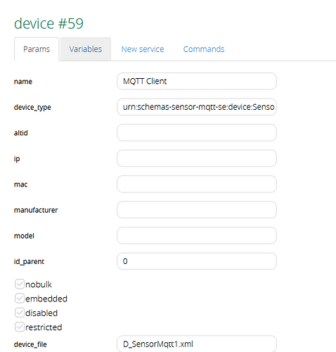

i’m trying to connect motion sensor to vera via MQTT. The issue is that the device that is sending the MQTT has fixed payload and its eather True or False and i can’t change it to send Status:1 or Status:0, does anybody know how to modify mqttTarget variable so it can translate The True value to trip the sensor and false to untrip?

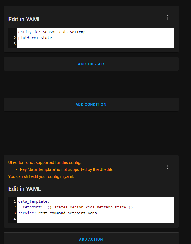

Thanks for attending to my request which is appreciated. However, sofar no luck in getting the value across to my vera for which the following applies:
Thanks a lot, got it working. In further checking it transpired that the service was not listed under Developer Tools - Services. This was because the rest_command was accommodated under the sensor directory. After putting it in the configuration.yaml, all works fine. Thanks again for sharing and thinking along with me.
