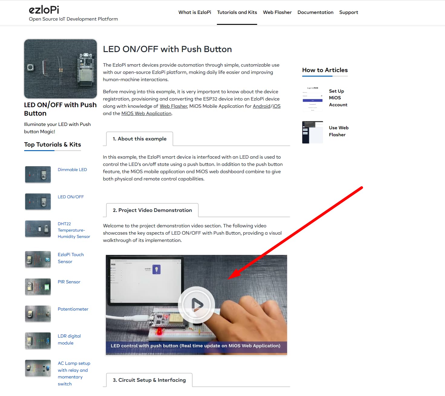

FYI, for ease of use we are also introducing Videos for each project so that makers can see the end result
