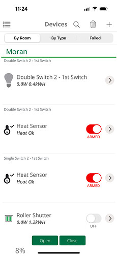

I gave it another try and it partially worked.
Although the migration screen stayed at 60% until the entire session was timed out, the EZLO reboot was done.
I logged into the GUI and I see many devices ( I didn’t count to see if all exist ).
The main issue is that many devices were wrongly identified and I can’t use them.
IMG_9944
Is there any way to change them ?
Most are Fibaro switches ( different types )
Thanks,
Nir

Hello @nirgal,
Thank you for your feedback and for giving the migration another try. The feature you’re referring to is currently under review by our development team. However, we don’t have an ETA at this time.
In the meantime, we recommend manually moving your devices to the Ezlo controller. While this approach requires some effort, it will also help ensure you have a properly updated and optimized Z-Wave network.
We appreciate your patience and understanding. Please let us know if you need assistance with the manual setup process.
