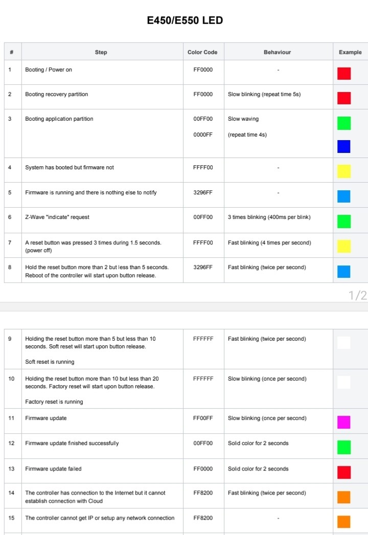

my controller is now flashing red, has been all night. It is also “offline”. Not sure what to do.
This says flashing Red is Booting Recovery Partition.
If it was me I would unplug the power and wait for the battery to run out and for the hub to fully power off. Then turn it back on and see if it boots?
