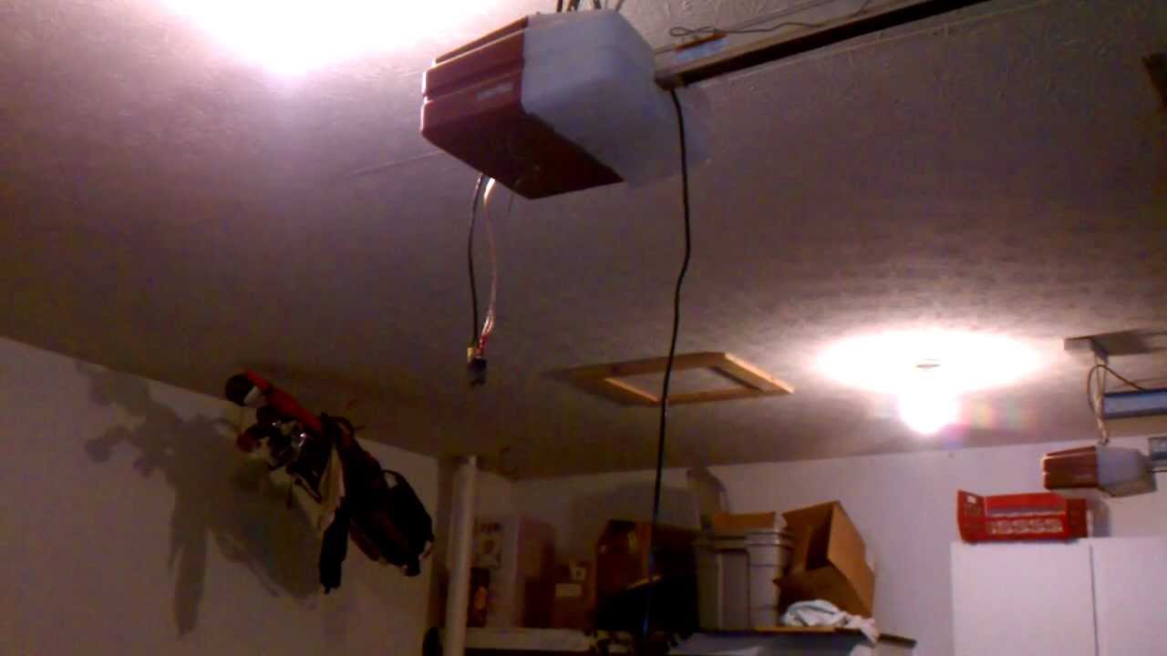

Has anyone ever experienced any lockups with this relay???
Not with the relay, but I did experience lockups with a GE receptacle that was installed in the ceiling above the garage door opener.
The receptacle lockups stopped after I changed the metal gang box it was mounted in, to a plastic one.
I’ve since added the relay to the same box, and for good measure, in case it’s a radio reception issue, I drilled a small hole in the cover plate for the antenna to stick out of.

Thanks JOD.
That is interesting… unfortunately I am using a plastic box already which is sitting on top of the garage door opener. Keeping my fingers crossed that the warm weather here causes the issues…
