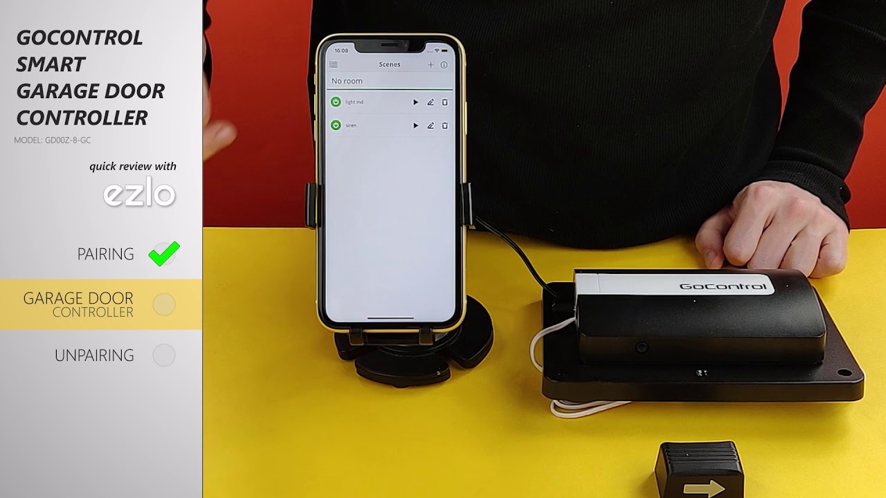

I have 2 GoControl/Iris GD00Z Garage Door Controllers and have had them for a few years now. For the most part they have been pretty solid. One of my units would need to be reset every 9 months or so, but honestly I haven’t had an issue in over a year now. Until now. Both units stopped controlling my doors. Within Vera, it would send the command and I would get the Successful message back, but the controller would never actually open the door. I spent a few hours, and probably a dozen attempts, this morning trying to get it paired back to my Vera Plus hub. I even moved my hub within a few feet of the Iris controller. Every single time it would detect the device, but fail to exchange security keys. I’m frustrated and looking to move on to something more reliable. I don’t believe these units are Z-Wave Plus, but from the looks of it, you can now only find the garage controllers used.

I have one of the GoControl units that started acting up right after it was out of warranty. It’s been abandoned for support but what I did find in a couple of forums out there was a fix. Rather technical, the problem has to do with the led light/lamp on the board and how the circuit was designed poorly. Most of the problems with the unit are remedied if the led is either replaced or bypassed with a resistor. Involves light solder iron use. In my case, the fix worked great and the GoControl opener has been working flawlessly ever since, including solid connection with Vera Plus over Zwave.

I also have two Linear/Go Control units. One started acting up last year and I did the LED fix on it. That has worked until recently. While it still opens and closes the door properly I’m getting false door open reports which I presume is related to the fix.

When my GoControl was working, and I would get the false readings, it was due to a low battery on the open/close sensor. I have not tried bypassing/fixing the LED yet though, so I can’t confirm that your issue is exactly the same as I had.
the tilt sensor is not using Z-wave and it uses proprietary 345 MHz. I hope nothing interfering the tilt sensor’s radio in your garage. Make sure also about the range 100ft line -of sight. Battery life is quite good with that approximately 24 months. (of course it depends on how often do you use your garage door)
That is essentially the same controller I have although mine is so old that it was called Linear at the time. While I appreciate the suggestions for getting my current ones to work, or replacing with the latest version of the same controller, what I’d rather do is replace with a different controller. They’ve always been one of my more finicky z-wave devices
