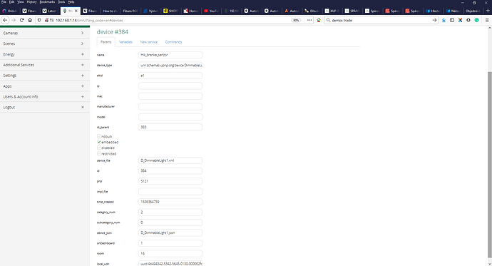

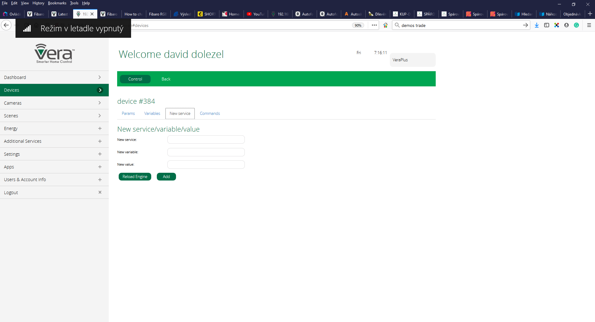

You need to change the device’s params.
Go to Device Options, then Add configuration Settings and put this:

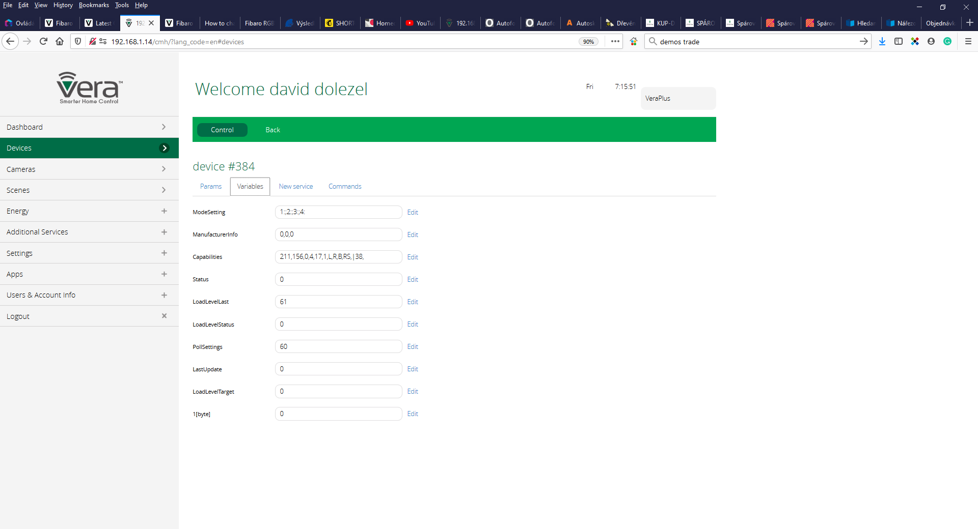

Managed to do this finally by removing the device and adding back.
But what I am doing wrong: I send 1 minute signal to RGBW and it turns on after the signal ends, not when I start sending?
