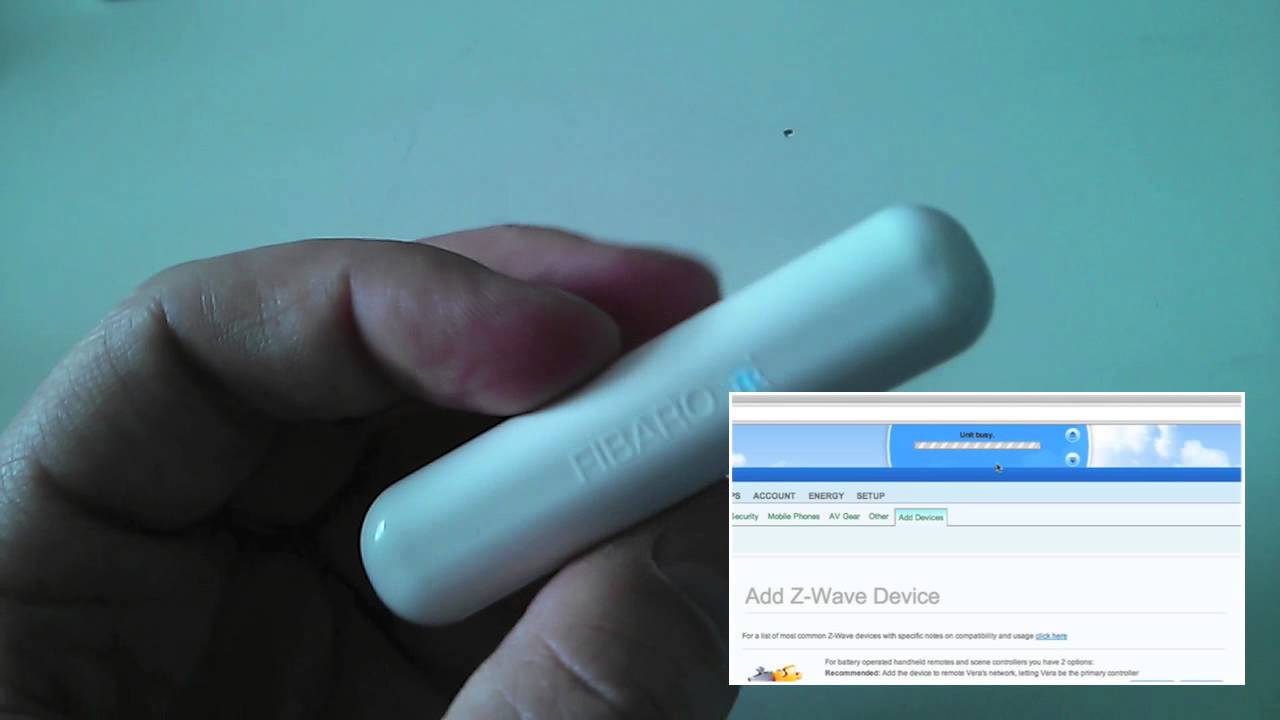

I set up my Door/Window sensor with this video.
Don’t understand the language. But it works.
[quote=“sglue, post:151, topic:173593”]I set up my Door/Window sensor with this video.
Don’t understand the language. But it works.[/quote]
It’s in Dutch, I did follow that video as well (I’m Dutch so that was easy), but got the problem described earlier.
