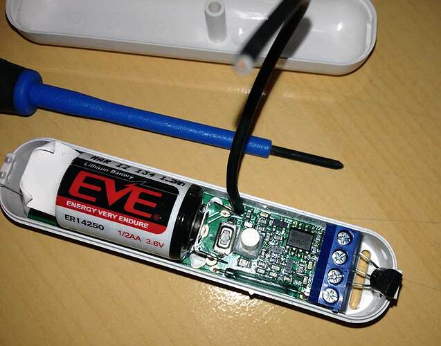

Perhaps these pics are helpful:
Especially:

P.s. Temp sensor should be mounted with the FLAT part DOWN (as in the pictures that oTi@ has posted and as is stated in the manual)
