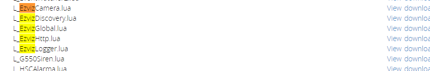

Has anybody manage to include Ezviz cameras in to vera controller?
In luup files i see multiple implementation files for EZVIZ cameras.

No the Ezviz camera don’t have HTTP MJpeg snapshot, it does not have a web server also. But the new Vista Cam 702 is oem of Ezviz camera https://www.ezviz.eu/wifi-cameras/ezcube/ so it has to have the engine to support ezviz cameras as i said the implementation files are present in vera
Maybe someone from vera team can shead some light, because if the engine is there why not use it.
I don’t know about native support from Vera.
