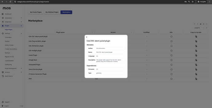

Unfortunately, we do not have a plugin to connect the panels via USB at the moment. However, the EnvisaLink 4 module is compatible via network (IP), and the plugin is available at ezlogic.mios.com → Plugins → Marketplace.
