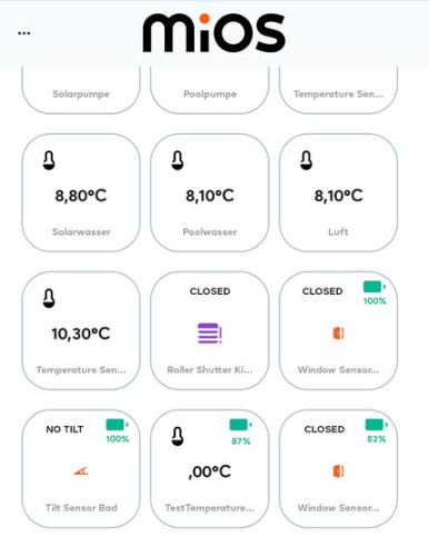

I like the design of the dashboard and the tiles so far.

- The app is pretty prone to crashing (I’ve already emptied my cash and reinstalled the app). I have the feeling that this happens when scrolling

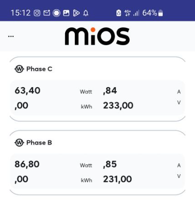

- When scrolling, it often jerks and the tiles sometimes have double contours
- When I go to the settings, set the dashboard to “always on” and then go back to the dashboard, the old dashboard version is displayed
- For values below 1, no 0 is displayed in front of the separator
- There is no way to set the roller shutter (in this case a Fibaro Roller Shutter 2)
