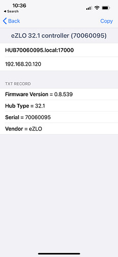

- At this point the Atoms are connected to my WiFi (I can see them in my router logs and on the network using an MDNS browser) but they refuse to connect to the cloud.

The Serial Numbers are 70060017 & 70060095.
