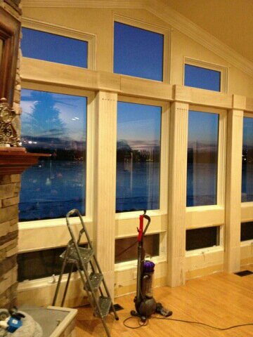

Just for fun here is a pic of the rough partially finished job. You can see the grooves / channel that will allow the blinds to slide down into. The blinds guy knew this was new construction and only gave rough dimensions to the carpenter for some odd reason only to find he has no clue wtf he’s doing and we had to tear this all down to re route the channels… I’ll get off my soapbox now.
