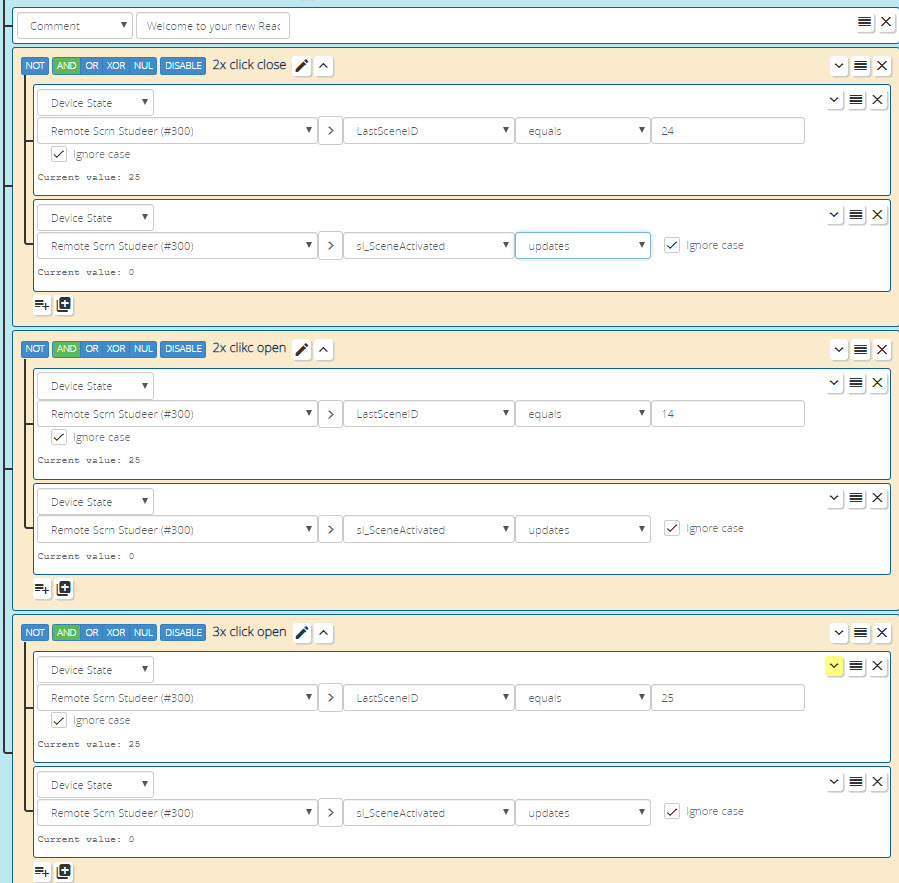

I searched for sl_SceneActivated and found REACTOR conditions below
sometimes 2x/3x click works and sometimes not. I think it has to do with the condition below that works well in PLEG but that I cannot build in REACTOR because I don’t understand what PLEG does with circled conditions
Maybe you can build this in REACTOR

The REACTOR example on the forum put me on the wrong track. I picked up the fibaro 2 shutter documentation and it told me the scene variable is SceneID in stead of sl_SceneActivated.
Now I have set the following settings in REACTOR for Fibaro Roller Shutter 2 and it works !!
  • Device State, scene controller device, LastSceneID equals 15
  • Device State, scene controller device, LastSceneID updates
Thank you for the explanation and tips. You helped me further
I have tested the reactor settings above mentioned for a period. It is better to set the Reactor settings below
  • Device State, scene controller device, LastSceneTime updates
