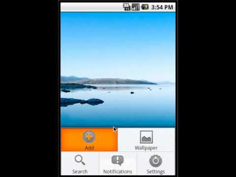

Use scene shortcuts. Here’s how to add one (screencast was taken using a MUCH older version):
