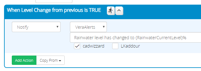

Hi, thanks for assisting. Really appreciate this. I have some other 40 reactors with way more complex features, but this one is being tricky :slight_smile:
logic 1
Actions 1
(The poll hourly is because the Fibaro RGBW 2 seem to update randomly and not consistently during level changes when used with 0-10v sensors, but they do when they are polled)

OK… I’m not sure of the units of measurement are here, but I’m going to assume they are arbitrary and you are looking to detect a percentage change between a prior value and current value (I’m taking the title of this topic literally).
Reorder the expressions you have so that RainWaterPreviousLevel comes before RainWaterCurrentLevel, and use the expression RainWaterCurrentLevel as the entire expression for RainWaterPreviousLevel. Expressions are evaluated in order, so by having RainWaterPreviousLevel evaluate first with just RainWaterCurrentLevel as its expression, it will save the previous value of RainWaterCurrentLevel before the next evaluation gives it a new value. I hope that’s not confusing. :slight_smile:
Then, add these expressions:
RainWaterChange expression: abs(RainWaterCurrentLevel - RainWaterPreviousLevel)
RainWaterPercent expression: RainWaterChange/RainWaterPreviousLevel*100
Then the condition:
  • Expression Value RainWaterPercent >= 1.0 (or whatever percentage threshold you want)

All done and currently registering 20 for the first two expressions (you are right % - but the value is displayed in the sensor as a light/dimmer slider, so always will be 0-100) and 0 for the last two.
I was getting null values and wondered why, but after using my eyes I realised you wrote RainWater where my variables were Rainwater - makes all the difference! :smiley:
