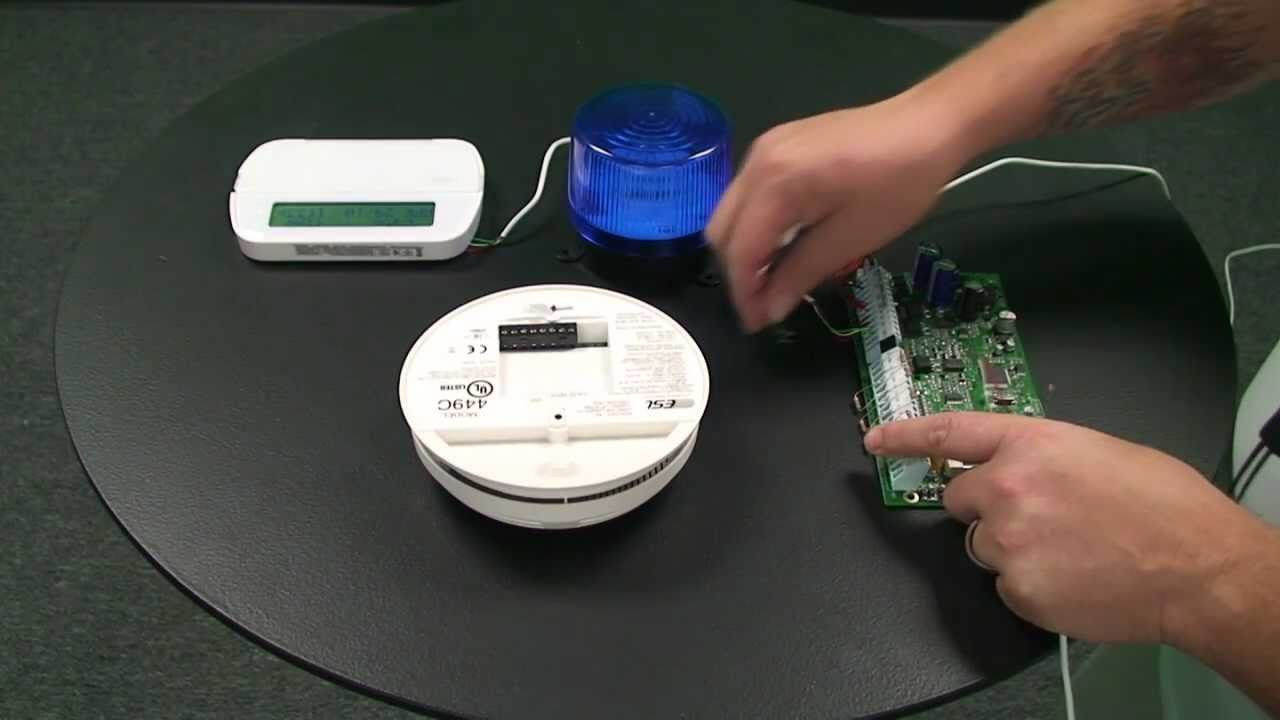

Have a look on google search for DSC Smoke Alarm video
