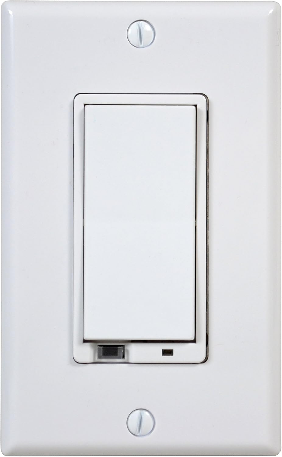

Or is it possible to just replace the primary with a 3-way switch such as the following?
What you currently have installed are two 3-way switches - they allow you to turn a light on or off from either switch location. If you want to use a Z-Wave compatible switch to replace them, you need to replace both. There are two ways to do this:
With the GE product (or a similar product available from several other manufacturers) you provided a link to. One of these switches (the master) controls the actual load and performs the communication with Vera, the remote is designed to use the existing “traveler wires” between the two switch locations to control the master. A conventional 3-way switch cannot be used to control a Z-Wave master. You must use the remote specified by the manufacturer of the master - it is not a standard Z-Wave 2-way switch, and it is specifically designed to remote control the master using the in-wall cabling that currently exists between your two conventional 3-way switches.
With the Linear WD500Z you provided a link to (which functions as the master) in combination with a WT00Z1 remote switch. The WT00Z1 uses Z-Wave to wirelessly control the WD500Z master - no existing wiring connection between the two is required.
Note the GE product you provided a link to is on/off only - but similar on/off/dimmer products are also available from GE and others. The Linear product you provided a link to is on/off/dimmer.
