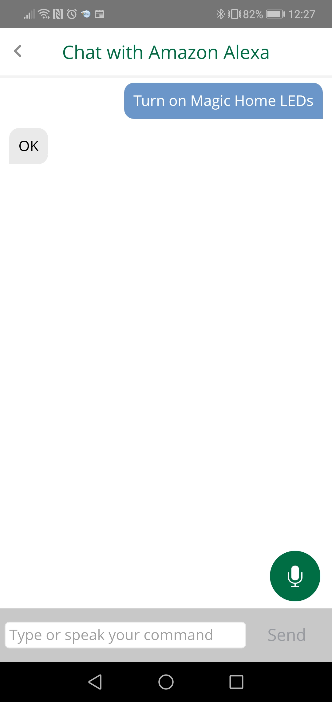

EDIT 2:
EZLO VOI for Alexa chat works I can type the command and it does turn on the Magic Home LEDs OK.
Screenshot_20210424_122726_com.vera.android
The LED controller device does then change to ON in the actual Magic Home app.
